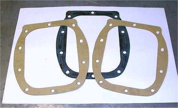

Hi Wouter,
No question of producing gaskets that can be obtained still - but this really all about sourcing diff pan gaskets which are unobtainable now in the UK.
I am intending to start a gasket 'bank' but as a reference collection so that in the future someone has at least got an example to make a template if supplies 'dried up'. Earlier in this thread I mentioned a few but simply because I have those lying around already.

Does nobody want to test a 1.2mm diff gasket ?
I have sourced an old gasket, made a template, researched materials, purchased samples, made gaskets, have a 1.6mm currently under test, (which is on Varts 5sp.conversion project). But as I no longer actually own a 300 myself (throw that man out they all cry) I don't have another test car.
If I am to progress this I need a leeetle help here.
(now he sounds like he's in a huff) but if there really isn't any interest out there and people are happy to make their own then I won't spend any more time on it. I'm cool either way.

Hi Graeme, thanks for responding.
As you know diff gaskets are no longer available and I am looking at suitable materials to make replacements.
The original gasket was 1.2mm thick, of an aramid composite with very low compressability. (Centellen WS3820 which is expensive in small quanties))
I am considering using an alternative (cheaper). I am already testing a 1.6mm material which will equate with 1.2 when fitted and the cover bolts torqued up. However I would like to try a 1.2mm thickness in the same material which would not only be cheaper (bulk supply is priced by total thickness) but also easier to stamp/cut out to shape.
All I need is for someone to actually fit a gasket and monitor it for a period to make sure there are no seepages or leaks of oil. The material is of an adequate spec. and has been used in automotive tranmissions before so I do not anticipate any problems. I have no doubt that 1.2mm works in theory but I need to make sure that it works in the real world.
If you could PM me your name/address I'll pop a gasket in the post to you and you can try it when you get a chance.
Whichever material/thickness works out in the end I would hope to produce diff cover gaskets to order for v3m for the cost of the material and postage (obviously the test gasket is free).

Now that's my sought of price-I'll take a dozenmac wrote: (obviously the test gasket is free). .
Mac, I'll PM details and try and wop it on in time for the Robson-100+ competive miles should be a decent test
If you could either post or PM what torque settings you recommend and what lube- got plenty EP80/90 but there has been differing opinions as to what to use.

Hi Shimon,
I'm sure I can test another - PM me your real name/address and I'll get one off to you.
Graeme,
I'm sure this has been posted before but to confirm:-
Volvo specifies Hypoid gear oil SAE90 (to API GL5 or higher) You probably won't find a straight 90 in most places so use SAE80W90.
Cover bolts are torqued to 9Nm (Haynes says 8Nm) It is ok to 'nip them up' a little if there is any seepage - but any more risks cover distortion (which I suspect is the main reason for diffs leaking anyway).
