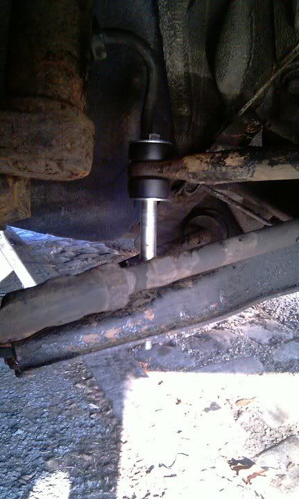

Post by samueljon » 03 Apr 2011 02:37 pm
still having trouble with the drop links the bar is the same diameter from top to bottom
picture bellow shows the issue
(i know the washer is in the wrong place it falls down the drop link otherwise)
Re: Performance parts cat
Post by foggyjames » 03 Apr 2011 03:37 pm
Well I don't know exactly how they're supposed to work, but there needs to be some sort of larger diameter section which fits between washers 2 and 3 (counting from top to bottom) to prevent them from sliding into one another. That could either be a wider shank on the bar, or a piece of tube.

Post by jon-ovlov » 03 Apr 2011 05:16 pm
Totally right james. I also know for a fact that that arb link is totally wrong! :lol:

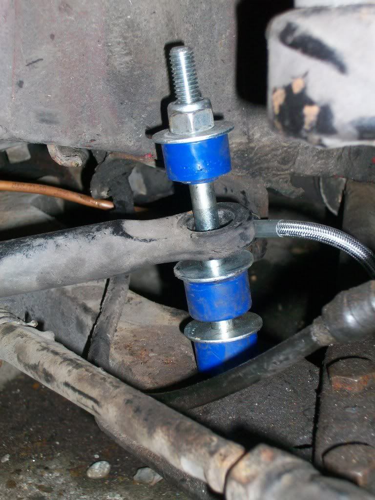

This is mine:
your kit should have come with two tubes, around 8mm inner diametre that can slide over the bolt. in the pic I took you cant see the bottom bushes, but imagine them being the same as the top.
The order should be (from bottom to top) washer - bush - lower bit of macphearson strut - bush - washer - spacer (tube that the bolt can slide through) - washer - bush - ARB - bush - washer - bolt through the whole thing, nut on the end. If you cant work it out, I'll get a better pic of mine. :D

Post by samueljon » 03 Apr 2011 06:23 pm
aaa im missing the larger diameter spacers!!
thanks guys i knew it didnt look right!
