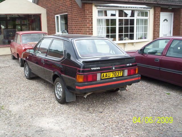

Re: VOLVO 343 DL Black Beauty Now with MOT
Still needs a wash but here are some pics
will do a few more little jobs on her today
Looks Ubercool man.
Wouldnt choose black and red for 300 colours myself, but the beast certainly does look handsome.
A splendid, hugely rare car! Well done ...
That is gorgeous... congratulations for getting her running again Stefan
