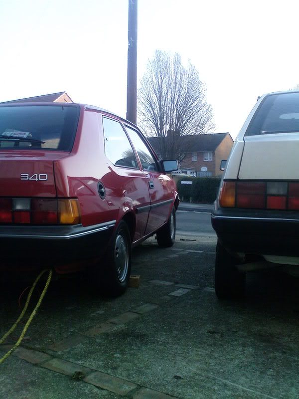

Vs standard ride height -

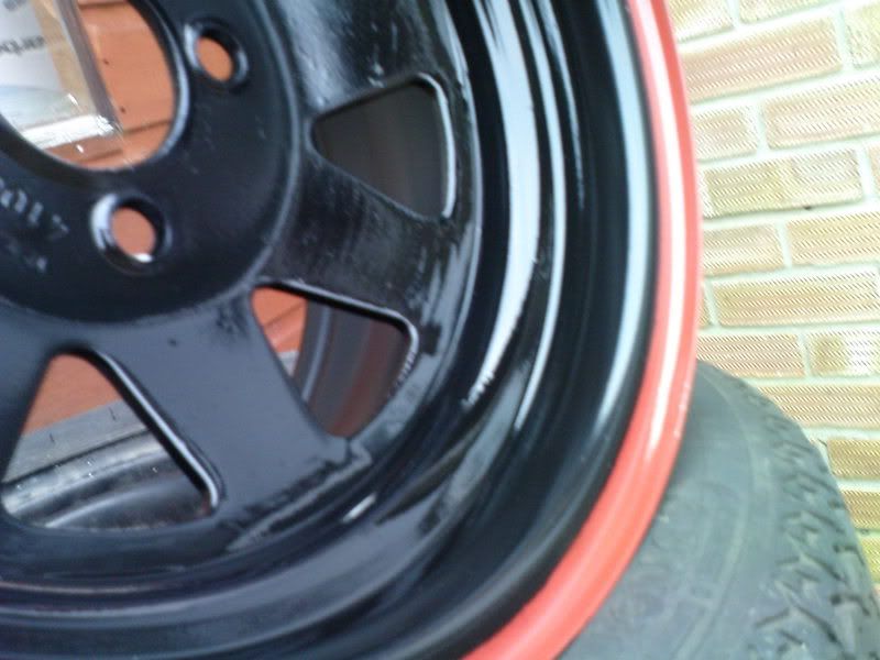

'New' wheels (weller 13x7) -

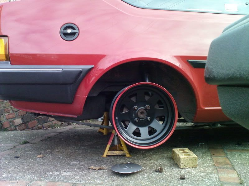

Test fit -
Sanded and primed -
Red rim -

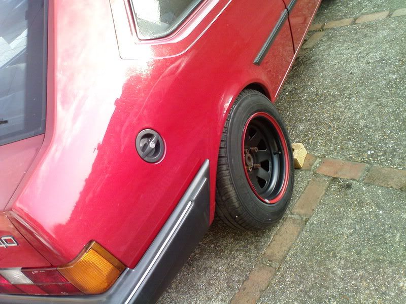

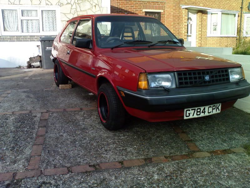

Finished -
Colour of the wheels are actually satin black rather than gloss, look a bit shiney in the pics because they were still a little damp.

Before anyone says it yes the front needs to be lowered to match - well no, it needs an engine in the front.

Looking sweet man, i really like those wheels. Is that a 2inch drop?

Yeah its a 2" drop at the back.
The front has actually been lowered (cut down mk2 MR2 rear springs and ep80/90w diff oil filled shocks) but I've only cut 2 coils off at the moment - The MR2 spings are quite long to begin with.
I'm waiting to get the engine in before I make any more changes to the ride height. Personally I'd quite like another 1/2 inch at the back. I think I'd be able to get away with the bottom of the car not scraping on too much becuase I've got 70 profile tyres on there at the moment. I decided to re-use the tyres that the car came with as they were all in good condition and it seemed a bit of a waste replacing them with another set.

what size are those tyres?

The tyres are 175/70/13. When they wear out I think I'll go for something like 165/55/13.

How wide are those rims? 7j?

Yes they're 7j, I did want 8j though! If I can find some at a decent price I'll get some but I'm happy with these for now.
