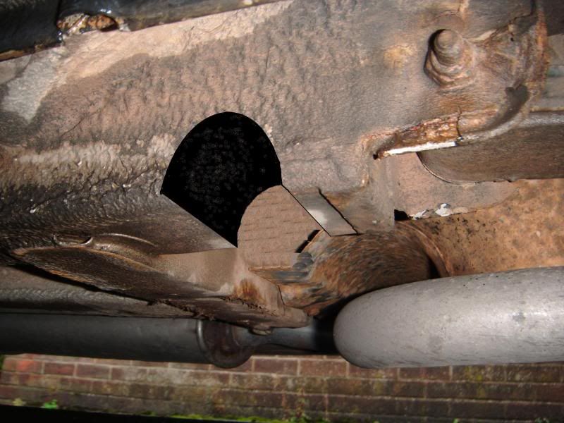

so with the plan to lower my ovlov ive been planning a side exit, i gets rid of all that weight at the back and is quite cool IMO.
To get that extra bit of clearance i was thinking of cutting away some of the chassis to make a gap for the zorst then welding a plate in the area i cut away. But before i do any thing drastic i'd like some opinions and advice, heres pic's of the plan.
i couldn't find any pics of anyone doing something similar, is it because its a bad idea

you definatly don't want to cut the chassis beam there, as that piece is the strength of the front leafspring mounting. it's quite easy to rout the exhaust pipe underneath that beam without it getting in the way.
Re: new member with a 360
As Anjo said, thats a direct load path for the leaf spring!
i did know that but i wasn't sure it was that important, so i guess i won't be going that route, thanks for the advice guys.
