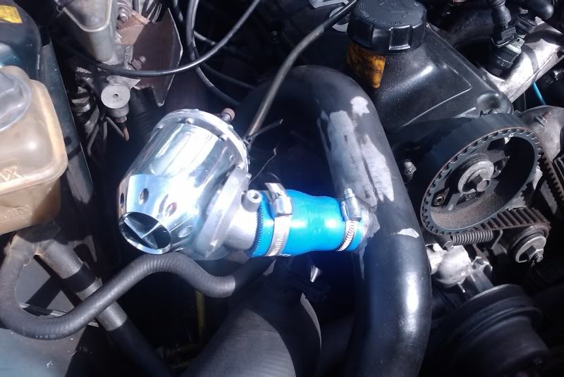

Here's a BOV fitted to a mates mates 940, with I am told no ill results
Fuck knows what it is. Some universal thing, but I am told teh 'spaceship' sounds good.
