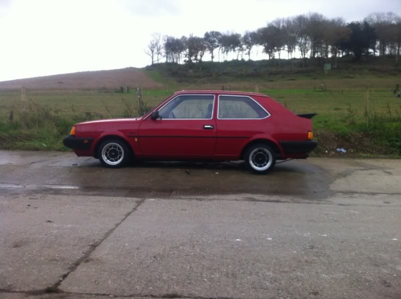

Bought this on a whim after deciding enough was enough, i needed something rwd.
this is how it looked upon collecting it;
after a polish
Unfortunately, without the ATS Classics :(
Spec-list seemed in-arguably good though,
1.8 F7P Clio Valver Engine
