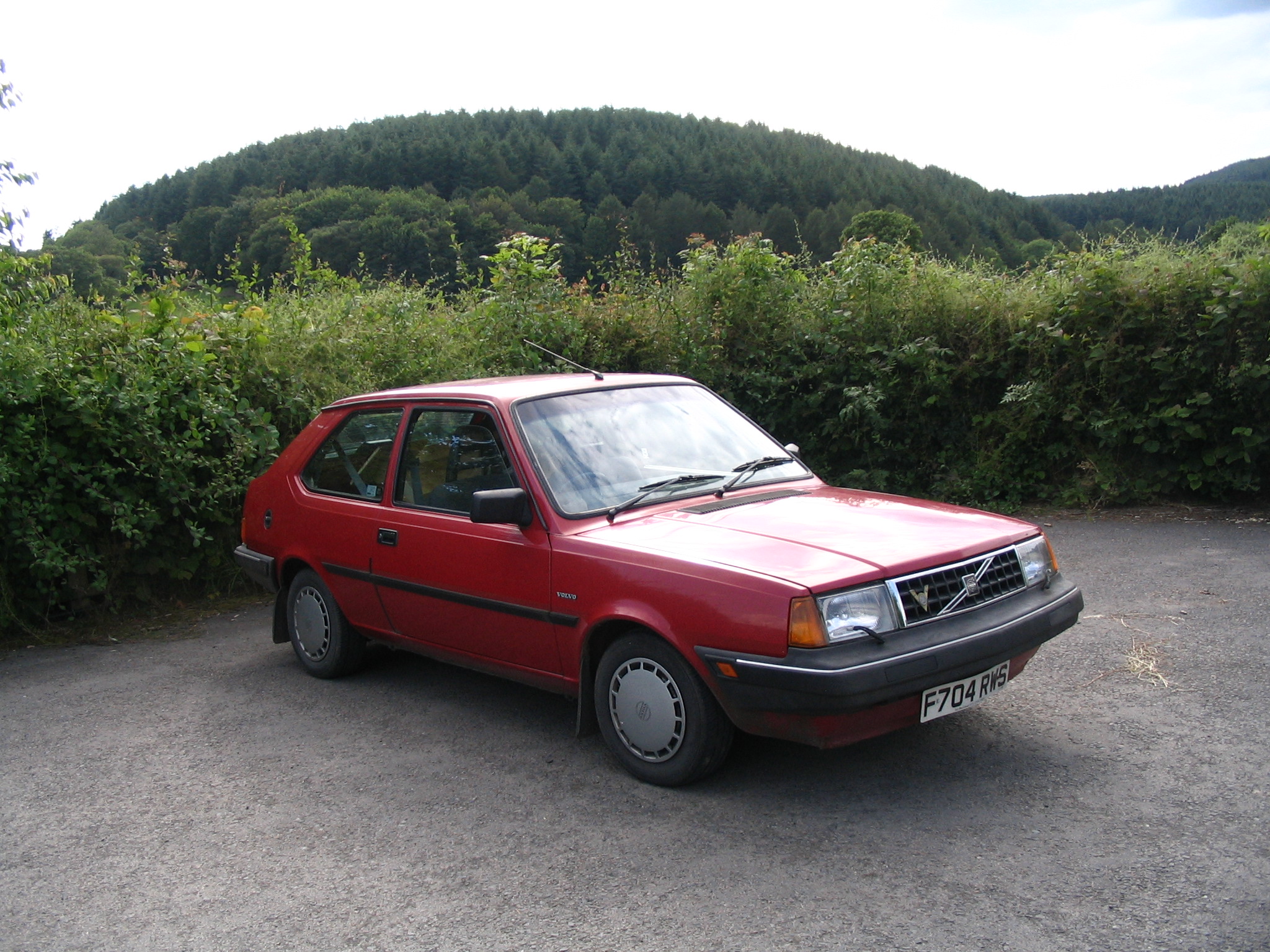

My wife and I are the proud owners of this red F reg 1989 Volvo 340 GL 1.7 5 speed that we have enjoyed since new.
Last week, after nearly 25 years 3 months the odometer passed 100,000 miles.
