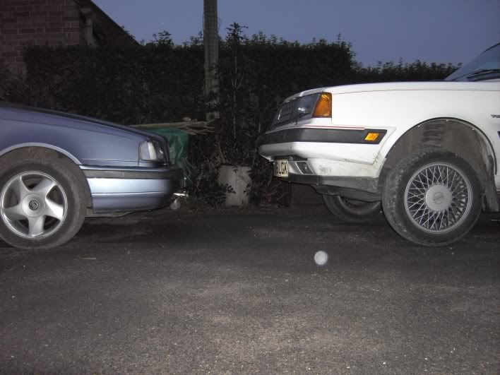

Who needs lowering when you can go for the jacked up 4x4 look with the 300!?
Just thought the picture looked quite funny, especially as it towers over the 460, which is meant to be the superior replacement for the 300, which IMO it isn't!
I was actually checking a noise coming from the front suspension at the time, and checking it without any load on the front wheels, and the nosie had gone, so I'm still thinking it could be either the anti roll bars or bushes under there somewhere. There are two to three distinct clunky/creaky noises from lock to lock (I don't dry steer btw) not always occuring in the same wheel position. It had a new steering rack before I got it not too long ago, however maybe something is loose on there? Any thoughts?
