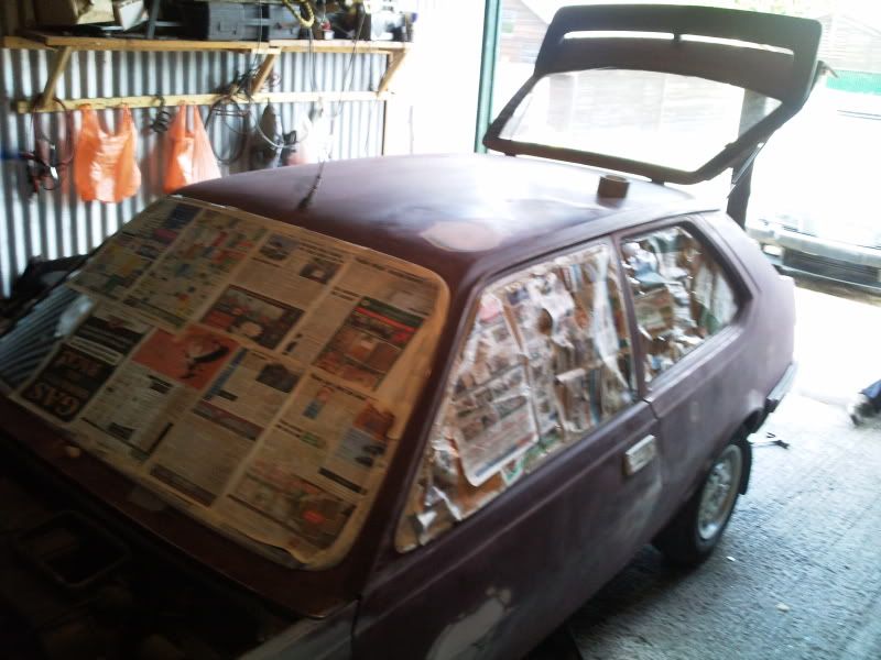

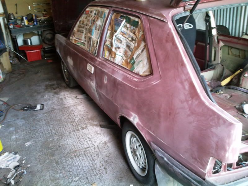

Ok today was a busy day, MOT is on tuesday so alot of welding took place followed by alot of sanding then a bit of fillering finally settling down with a lot of primering
The car is fully primered on the outside and thats how its gonna be until after retro rides. Not 100 percent finished yet, still a few patches which will need redoing where the dents are still visible. but its a start, and hopefully come tuesday ill be able to drive her again.

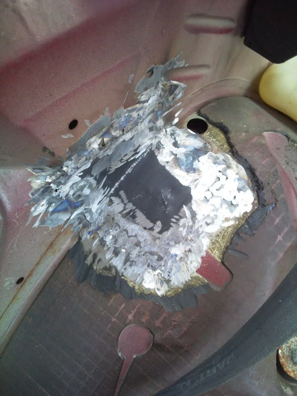

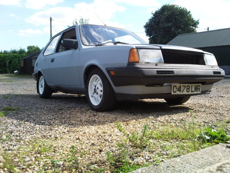

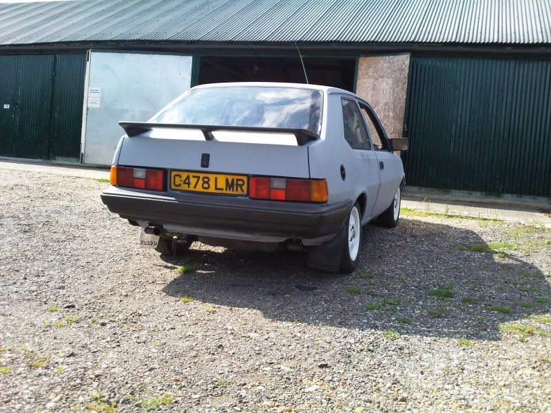

First of all removal of the massive hole of rust on the wheel arch:
Will have pics of the other side on monday as mates welder ran out of mig wire lol

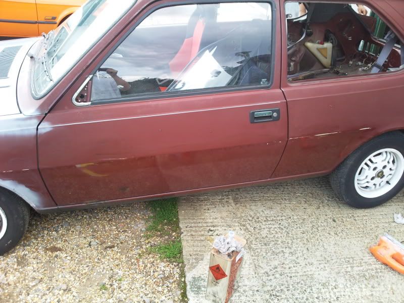

Rubbing strips removed from the sides of the car, along with all the badges, Very long and tedious work
because the paint is allready in very bad shape there wasnt much work needed to get it ready for spraying which was nice.

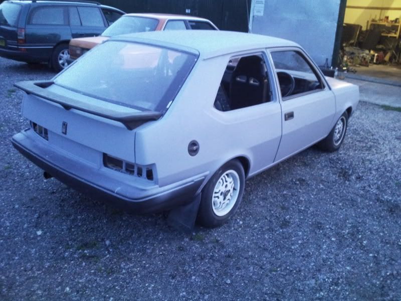

Time got on, so not many pics of the rest of the work just the final result:
The rear bumper got hit hard by primer so gonna have a go at cleaning it with thinners, if that doesnt work will get some plastic primer and spray it matt black.
Hope you all enjoy.
Dan

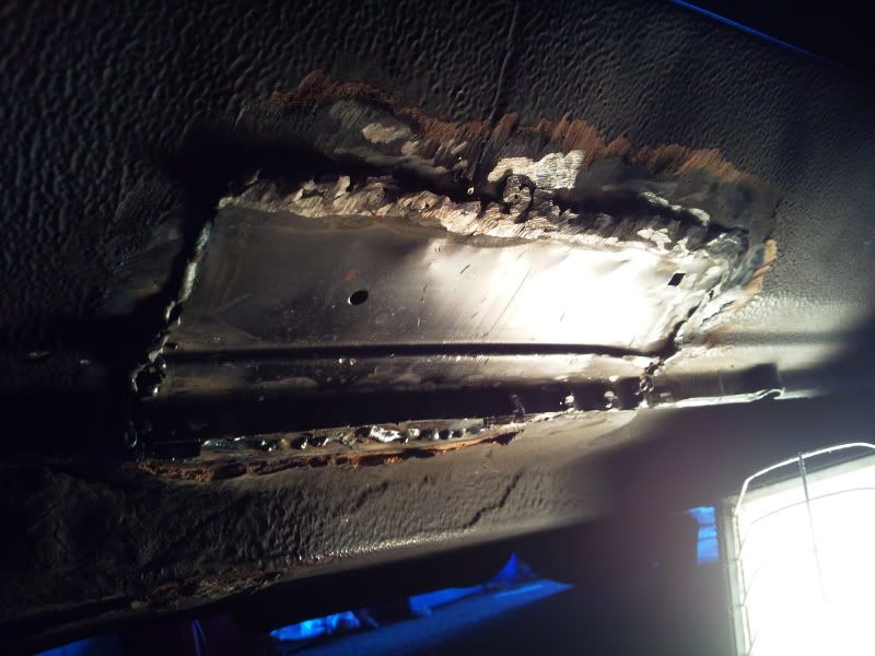

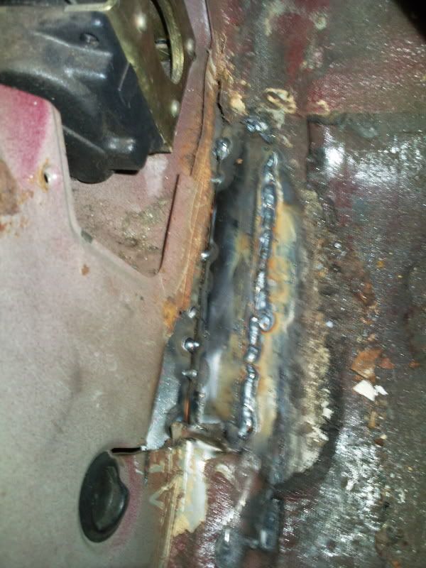

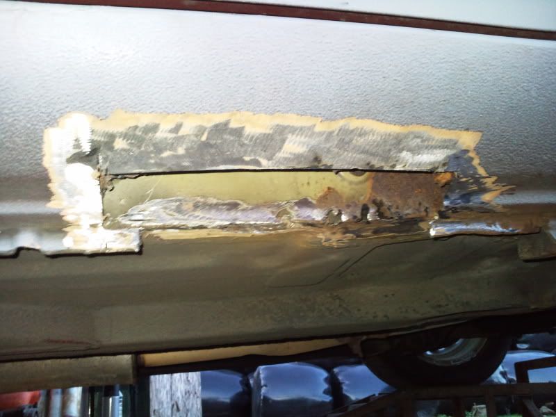

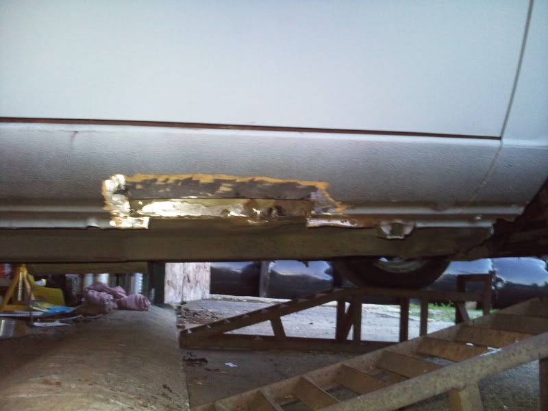

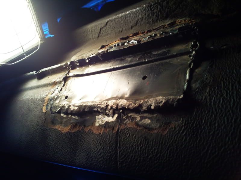

Rust repairs along middle of sill and inside car behind drivers seat, they dont look neat but neat can wait untill the mot is passed

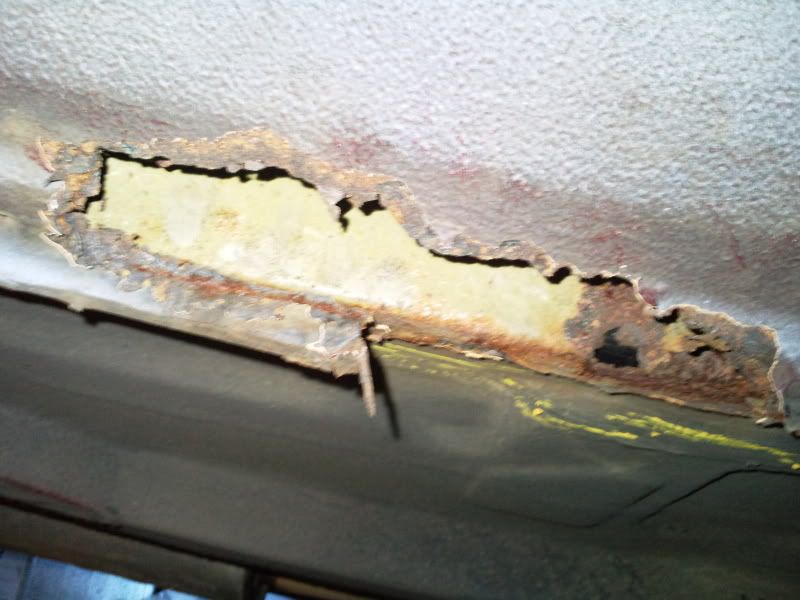

More rust along the front of the sill:
Rust cut out waiting fresh metal:
