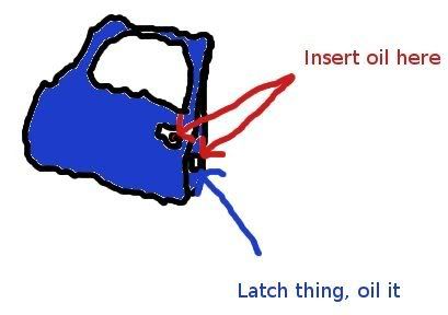

Jani, do you pour from the key side, or take the door card off? We Brits are pretty noobish at such things (or maybe it's just me
Re: jack frost locked me out
With my superior paint skillz I did made image to you, it tries to represent a door from car...
