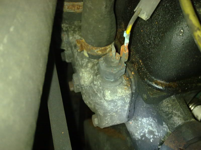

Hmmm well i've just been for a quick nosey out at the car and I think i've identified my temp sender, at the front of the cylinder head near to where the thermostat is situated.
I pulled the connect off it and goddamn the thing is cruddy as hell! If this is the temp sender I think I can see why it's not working correctly, look!
So i've just given both terminals a good scrub with wire wool and electrical cleaner and i've put it back on, so we'll see how things go on the drive to work tomorrow! May not need to splash out on a new one just yet!

Right then, quick update! Drove to work this morning in the hope to see the needle sitting below half way as it should during normal driving to which, no luck
No worries, it got me there and back no worries!
Once home I gave it about an hour to cool down enough to work on, i'd picked up some fresh new jubilee clips from work also. Got the top rad hose off and swapped the thermostats over, bled it up and took it out for a spin, the result?...
FIXENATED
it's heating up to just under half way now and stays there, as it should, that should help the ol' boy run a bit better, i'm sure running too cool all the time can't have been helping him run to his best.

Result! (But where was it sitting before?)griffo20022 wrote:Right then, quick update! Drove to work this morning in the hope to see the needle sitting below half way as it should during normal driving to which, no luckNo worries, it got me there and back no worries!

It was sitting just above the "C" all the time while driving. In traffic etc. it'd creep upto the fans kicking in point as it should, but as soon as you carried on driving again, went straight back down to just above the "C" again

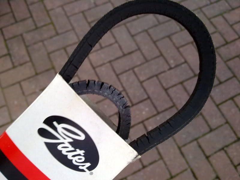

If you've seen my thread on belts you'll know the next part lol. Went to fit the new belt and was a right f*cking pain! So much so it didn't go on, I cross referenced belt lengths to find Halfrauds had supplied me with the older (shorter) belt, doh! (Luckily with my trade card the belt was less than a quid anyway lol!)
So anyway, I reluctantly re-fitted the old belt and carried on sorting the oil change out, I haven't done the fuel filter yet as I want to try get hold of a refurb kit for the original fuel pump including the original little filter inside as the one I got was basically a universal inline filter, so I want to do the fuel side of things in one hit.

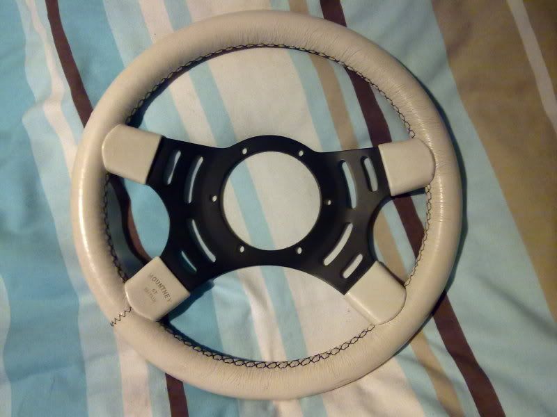

That weekend i'd been keeping my eye on an awsome oldskool Mountney steering wheel in funky off white/creamish leather on ebay which luckily I won
It turned up Wednesday and I can't wait to fit it, looks mega pimp hehe!
Just awaiting for VND to move into his new home so I can buy his steering boss from him he has up for grabs and i'll get that badboy fitted!
So we come to today... Yesterday I picked up my correct sized belt from Car Spares, got home from work earlier and quickly got on the job of swapping it over. This is why I was so desperate to get it changed.....
Doing 30-70miles a day comfortably along the likes of the M6, A38, A5, I knew that belt hadn't got much life left in it so made sure I got that nipped in the bud before it bit me in the ass! Probably the most essential £5 i've spent on the car up to yet lol! After I did that I've just been having a little tat cleaning up the engine bay a little. Wouldn't mind over time slowly cleaning it up and making it near pristine!
