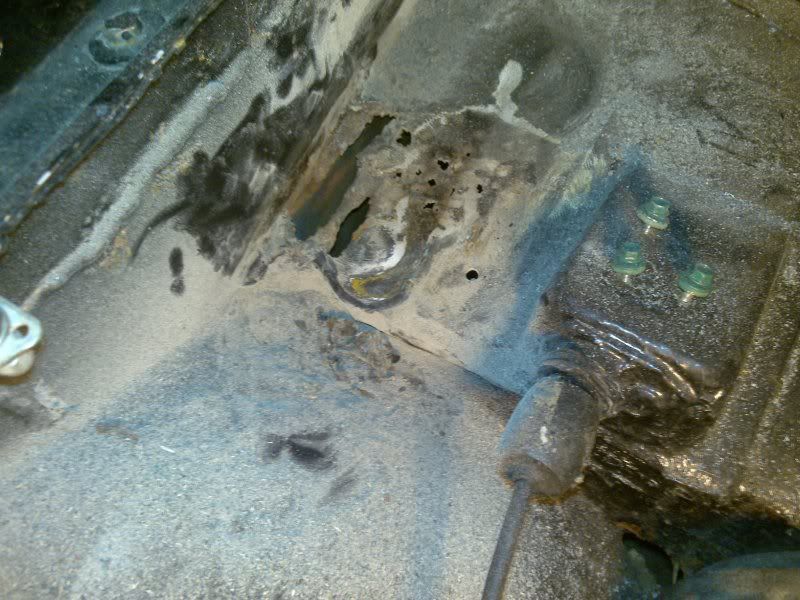

Makes your heart sink doesn't it when the screwdriver just makes a crunching noise and goes straight through
Best you found it sooner rather than later I suppose.

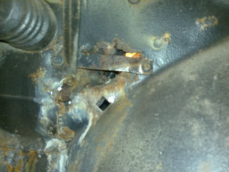

Looks like I underestimated the amount of rot by some margin. I got the screwdriver and went digging for peace of mind, but all I found was orangey-brown misery!
The only way to gofilthyjohn wrote: Chop it out!

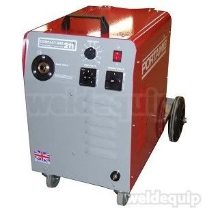

About 6 weeks ago I ordered a very nice welder, this Portamig 185:
But, it hasn't arrived yet and it'll be a while longer, they're custom built to order and they're behind schedule.

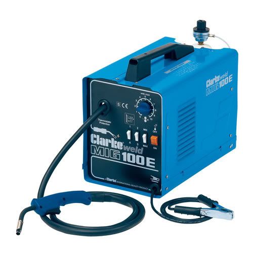

Luckily I've been cracking on with the little Clarkeweld 100E pigeon-shit-tronic mig,
and managed this little lot.

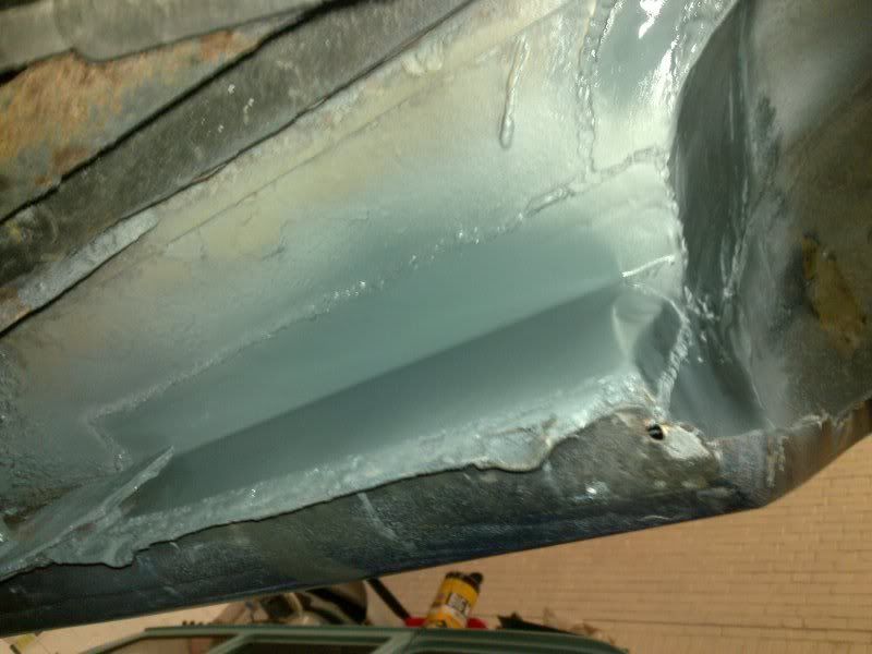

Above OSR spring:

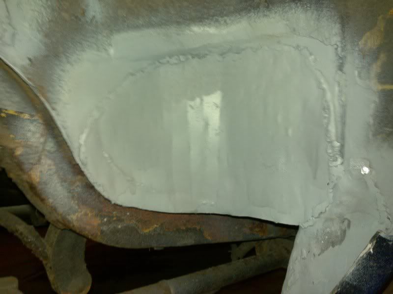

Wheel arch and sill end:
Inside was worse than imagined
And the back part of the inner sill:
All in all I'm pretty pleased, I've been working on it nearly every day, a patch at a time, and my welding's getting better all the time. A year ago I'd have been to scared to do it myself, but far better to take the plunge.

Bulkhead:
And above that:
Unfortunately the brake servo has to come out so I can do a proper job. Which is a real PITA, but hey ho, might as well crack on with it instead of sulking.

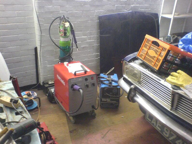

It arrived!
Re: Manta! Progress pics.
And the winner of the award for cleanest piece of equipment in the Unit iiiiiiiisssssssssssssss.................................
(drumroll)
Big Red Welder!
