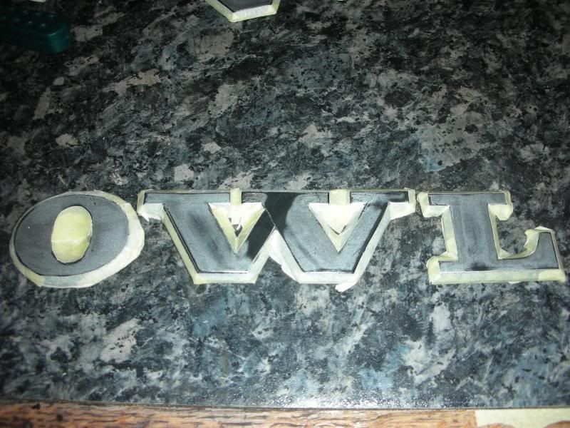

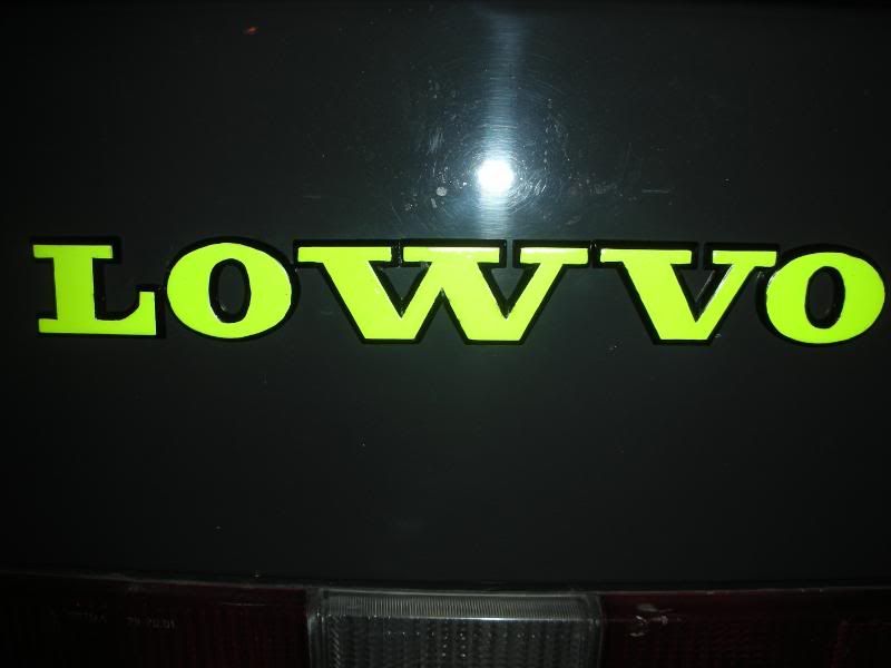

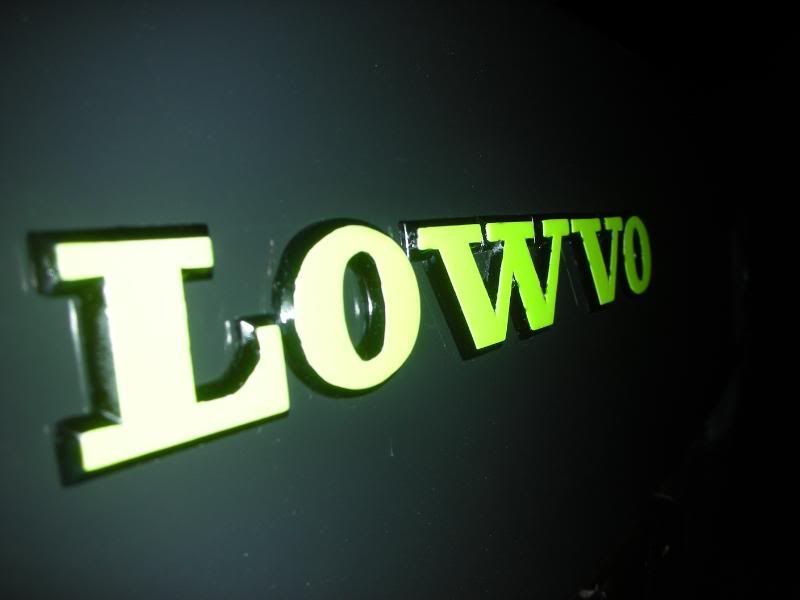

Now for wasting your time with my drivel i shall put some close up pics of my adjusted boot badge as i did it a while ago but haven't shown any close ups yet.
This was one thought, but then i thought against it :lol:
I settled for this which had been the plan since i got the car but in it's unlowered state i felt it to be unworthy:
Yes that is glow in the dark paint :P

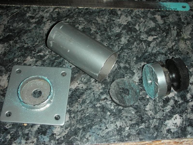

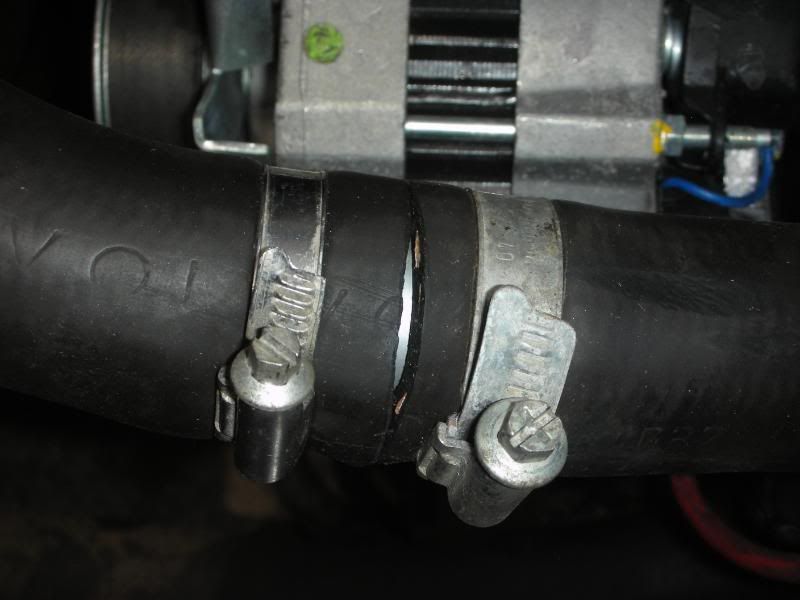

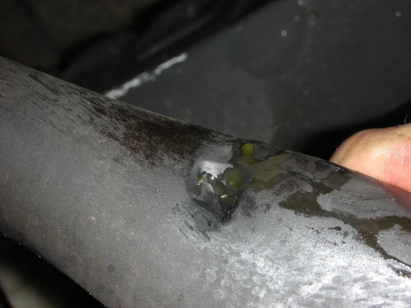

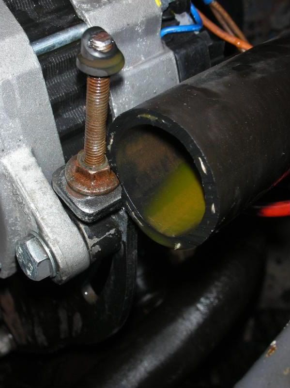

Driving home from dropping the bird off at work, stopped at my local shops to buy some fags. On returning to the car i notice some coolant on the floor. Pop the bonnet and the top hose has a pin prick sized hole rubbed through from the alternator adjuster. I knew it rubbed on here so i'd already put a small rubber tophat looking thing on it to prevent rubbing, but i found it had rubbed through that and the pipe.
Oh well the coolant bottle was still half full so it couldn't have been split for long and the temperature hadn't gone up so i topped it up and drove it home.

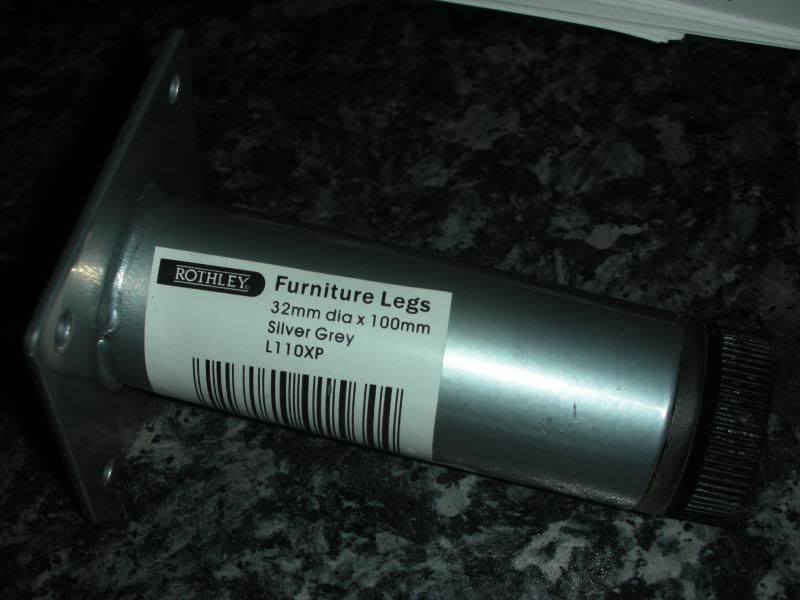

Now it's a Sunday lunchtime and as i don't have a spare tophose i had to try and get a sleve from somewhere so down to Wickes i went.
Nothing in 1,1/4 (32mm) so i headed to the mahooosive B+Q. I checked the plumbing section and again nothing in that size, so i wandered around the shop looking for something else i could utilise.
Then i found these :lol:
Thats handy, 32mm adjustable table legs, for the princely sum of £1.95. So i took it home and did this to it:
Then i filed the it down so it had a nice bevel with no sharp edges, next i attacked the top hose with a big kitchen knife and cut it in half where the offending hole was.
Here you can see the rubber boot which has rubbed through making the hole:
Next it was just a matter of slipping on a couple of jubilee clips on each end of hose, fitting my newly made sleeve, doing the jubilees up, add the little coolant it missed, run it up to temp with cap off, jobs a good un 8)

Leg-andary fix :lol:

Lol at the leg, awesome fix by the way although cant help thinking its quite sad i knew that was a 32mm pipe when i spoke to you earlier. :roll:

This looks rather familiar, I have similar in yank tank, there is bit stupid way how heater hoses run, right next to exhaust manifold, so it was no wonder that one day there were similar hole to yours. Had some supports for light summer shelter thing and got piece from there, couple of clips and it is better than new. Piece of metal wire to keep it away from exhaust manifold and that was sorted.
Solution works and yank tank has huge amount of extra hose, but of course hole happens to be around middle, so there is no way I'm going to throw away that amount of good hose, little bodge will be enough for that :lol:
