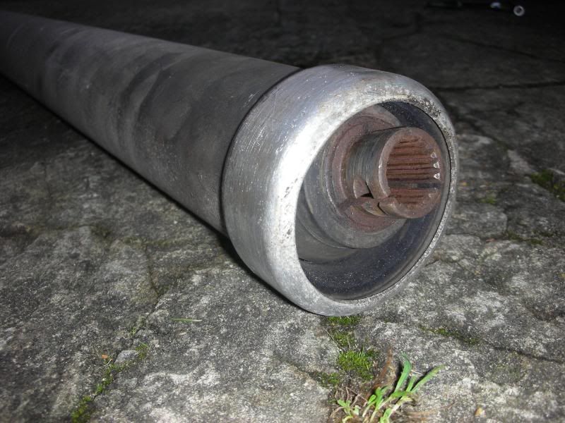

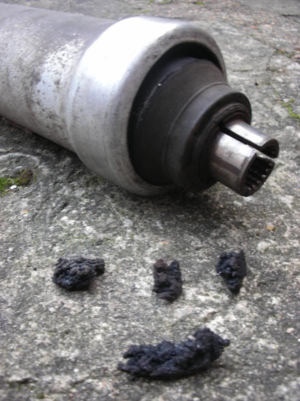

Obviously safety first kids, i placed my axle stands and crawled under. The front of the prop was fine, so i crawled to the back and all looked ok, apart from the molten rubber stuck to the floorpan, which can just about be seen here:

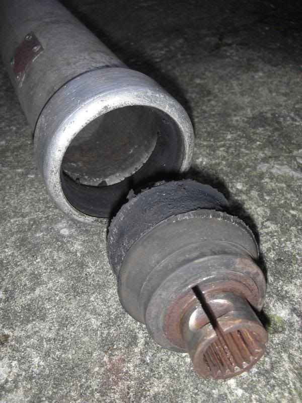

So off came the prop clamps, out came the rubber mallet and banging ensued until it came off the nose cone, it was then easy to pull the knackered end off of the gearbox. As suspected the rubber has gone in the prop. I take it these are glued in at the factory, but it's hard to tell, has the glue simply gone, or has the rubber fatigued over time and simple twisted and split?

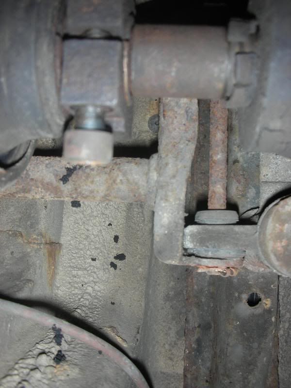

While under there, i've noticed the engine rubber is now like jelly, so that needs doing ASAP.
Melted rubber/glue
