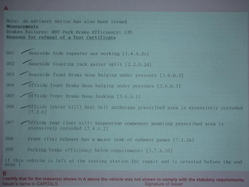

Friday rolled around so i rang them. Sorry we can't do your retest as the exhaust is blowing and we can't find the correct size flexi pipe. Bugger thinks i. Anyway i comandeered the car and took it to my mate who welds exhausts for a living, sorted and for £0.
Back to the testers on Monday, i went off to work again, and returned Friday, this time picking up my freshly Mot'd wagon for another year.
Lot's of silly jobs it failed on, see here:
Both front brake pipes bulging under presure doesn't sound too clever though!
I also got an Advisory "Near and Offside front strut modified but not seriously weakened", i can only presume this is because i've drilled a whole in the cup to put a nut and bolt through to hold the spring in place, tester said it wasn't an issue but had to be mentioned.

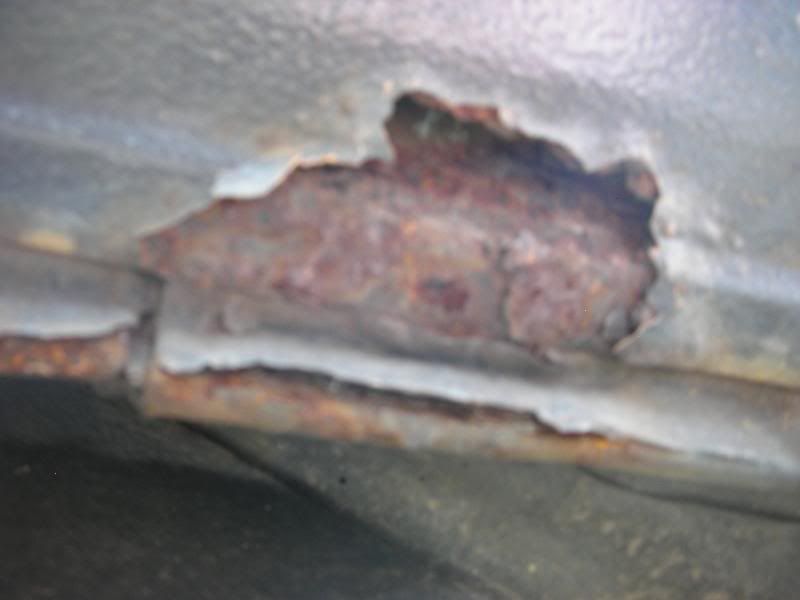

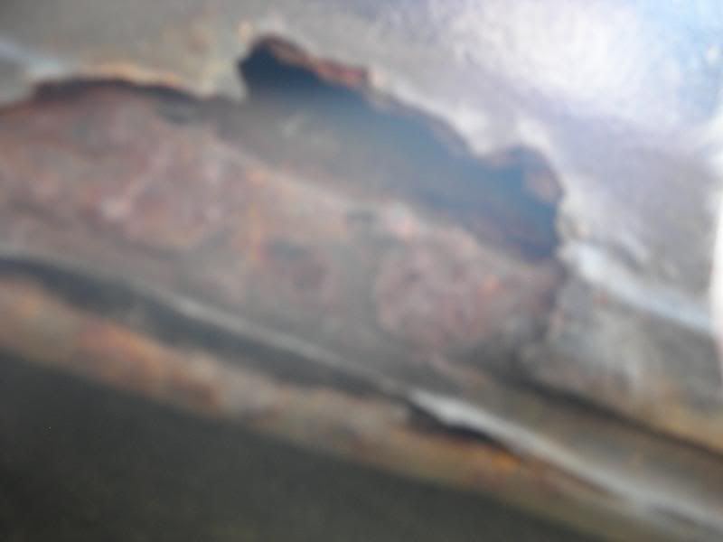

Here's a few pics of the cill after prodding with a thumb nail
. Yeah it looked a little crusty to me but don't touch it and it's fine is my theory.

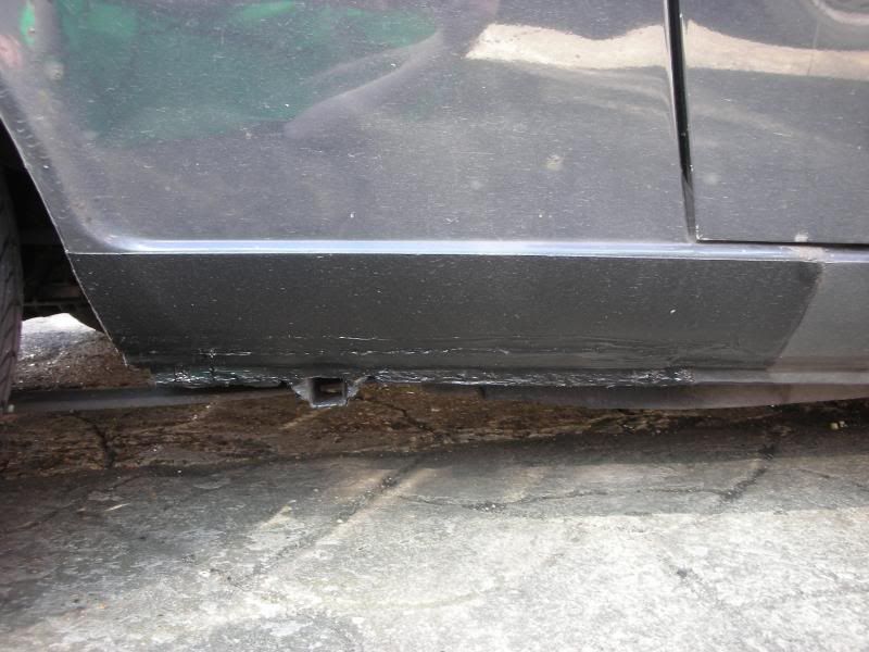

After repair it looks more like this:

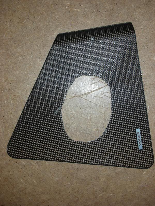

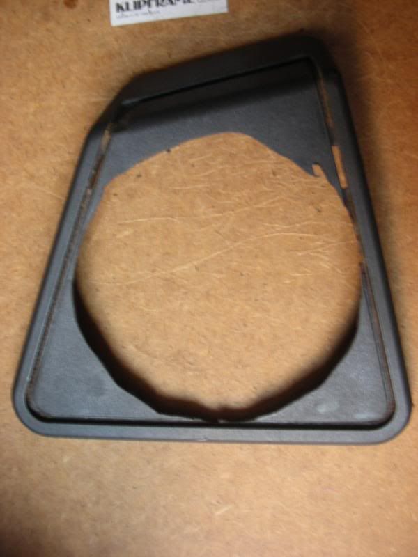

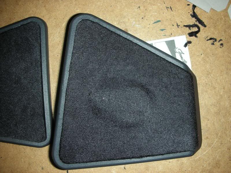

Well thats it of recent goings on but i've had these for ages and never posted about them. I think it was Liam who said how good Fli speakers were for replacing the stock fronts so an Ebay purchase was made.
To fit them i roughly marked out the shape of the tweeter onto the old speaker grill.
Then i attacked it with a mini angle gringer thing on a Dremmel and i ended up with this:
I also noticed the speakers fouling on the original housing so again with a Dremmel and file i adjusted these to suit:

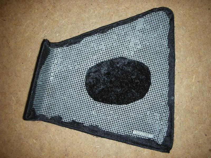

I then went to a local fabric place and purchased some black material in the hope it would look like speaker covering. I used the grill as a template and marked around the cloth with a marker, leaving a half inch over hang.
Out came the contact adhesive, which was liberally sprayed onto the grill and the cloth cover. I placed the fabric on a flat surface and put the grill onto that, then folded the other hang round the back of the grill like so:
From the front:
Then placed the whole lot together, managing to force the cloth into the original speaker housing grooves and voila' semi stealthy uprated speakers:

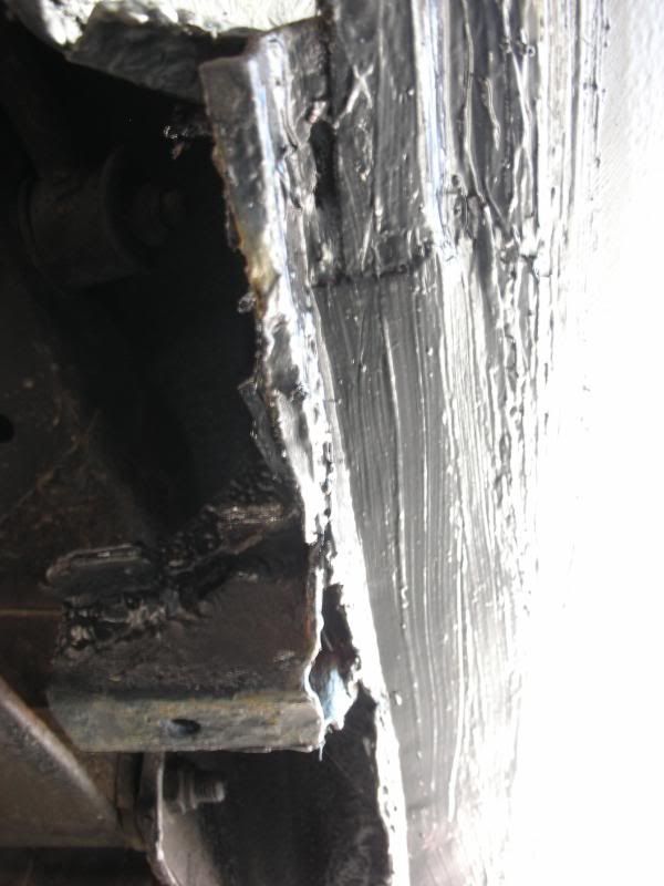

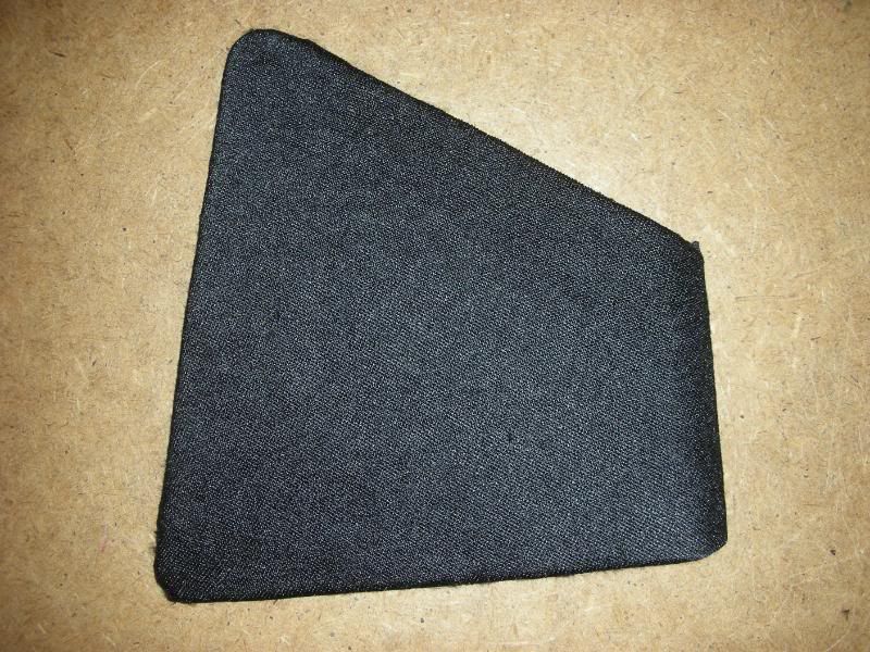

From the front:

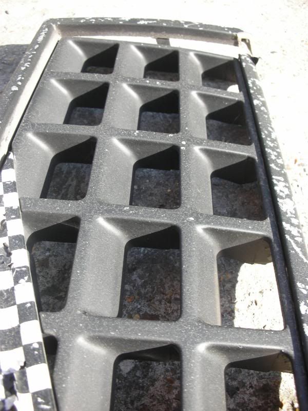

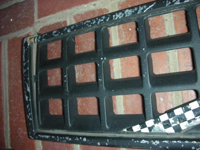

So i went out on the hunt for it and found leaning up on a fence at the side of the road, luckily just about still in one piece. Once i'd got out the car and taken a better look although in one piece it's scratched to sh*t and the corner of the trim surround is cracked, it's also missing all the mounting tags from the back. Oh well, another thing that need replacing.
If you've got a spare grill hola at me please
Unintentional tramp drift look:

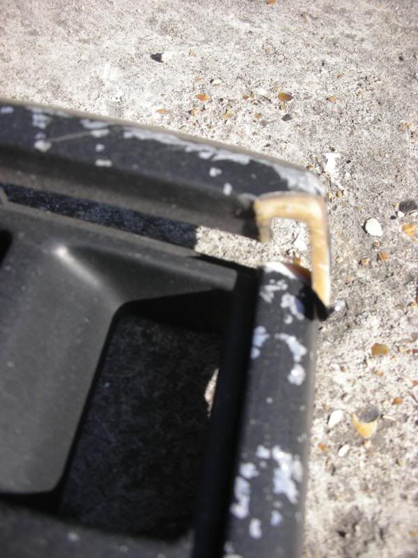

Close up of the damage:

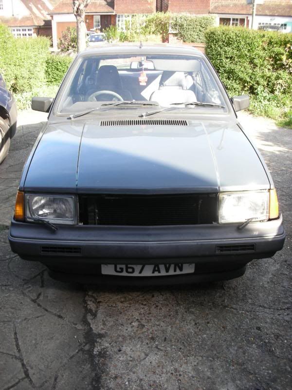

I went for a drive on Friday night, but annoyingly most roads round my area have speed bumps in of some description. Well as per usual i was going slow over them as if i don't the exhaust scrapes, well it still does slowly, just takes less of a battering. Anyway i went over one of the square ones, you know the annoying type they always put next to an island to make them unavoidable
Basically as i pulled away from it, i heard a noise and then the sound of me driving over something plastic. I looked in the mirror didn't think much of it and carried on my merry way. Saturday morning and i open the door to be greeted by a big hole where my grill used to be

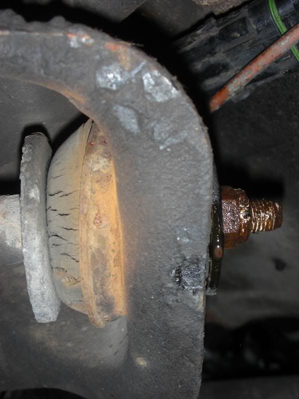

Little update, nowt exciting really.
I've felt that the front end is a bit worn when going down rough roads (see 99% of uk roads) with clonks and bangs coming from the suspension so thought i'd get under there and try and sort it.
It also has always pulled to the left a bit even with new tyres fitted and the tracking apparently being correct?
Anyway i bought some replacements for these off of Dai when i bought my lowering bits. I somehow missplaced them though, but they were unearthed a few weeks ago, hiding in the last place i'd ever look. In the bottom of our vegetable store
I also replaced the trackrods while i was there, however i haven't got any after pics of either, only before
Now here's the thing. I was hoping to change them and all would be well/better. Sadly that wasn't to be. It still pulls and if anything the front end feels even looser and vague. Yes i did do everything up tight after and has since been checked.
So my next port of call is wheel bearings as they are grumbling like an angry bear. What after that, i've got a feeling the steering rack is on it's way out. It also groans when on full lock while parking and the like.
* the drop link and wishbone bushes have yet to be replaced, could they cause the issues?

Steering rack if there is play in the ball joints (grab the rack and the tie rods...pull
) but definitely the wishbone bushes, they make a huge difference. It pulled my wishbones up square again when I did mine.
ARB droplinks don't affect the straightness, just whether the ARB does anything useful or snaps into action halfway through the problem
