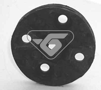

The GSF part is still listed as a PAS coupling, can anyone confirm it is for non-PAS? It says on another thread there is no damper on PAS, but its not clear this is a damper. maybe its a UJ.

I emailed GSF, and they said it is listed for non-PAS and PAS. They sent the following (unclear) picture. It doesn't have any integrated bolts, but hopefully thats not a major obstacle.

I've just bought a Citroen BX steering coupling which I'll hopefully try to fit during the next few days. I'll let you know how it goes but visually at least it looks identical to the original Volvo item.

I have now fitted the Citroen BX steering coupling and can confirm that it is a direct replacement for the Volvo item. Whilst I couldn't see much wrong with the old coupling the new one has definitely tighted-up the steering and cured the vagueness in the straight ahead position. Not bad for £6.50 plus a couple of quid for postage.
