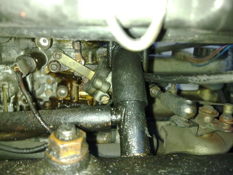

Well i'm a happy boy today! Managed to fix my little running problem easily and free!(if only all problems could be resolved this way! :lol: )
Top hose in this picture had come off the fitting causing the carb to lean out thus not running right with the choke fully off..

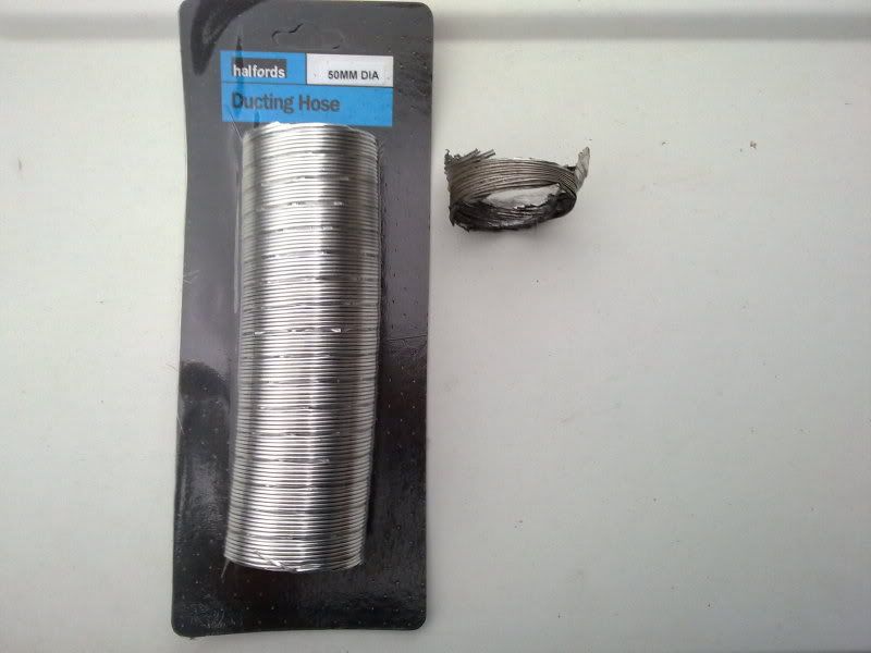

Glad that's all it was! So to treat Vince I picked up a new space tube for him as this was all that was left of the old space tube....
:lol: so hopefully should run that little bit better again now. Also before I fitted it I took the air snorkel off and gave the flap spring a spray with some silicone oil. I don't know how long that tubes been missing for so the spring probably hasn't been in use for a good while!

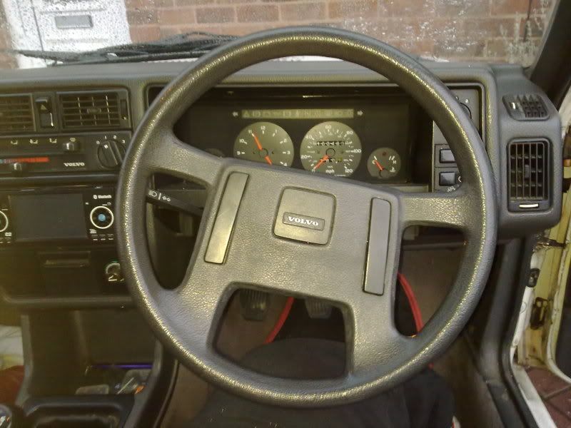

Hey guys, well with a MASSIVE thanks to mr VND I now have my awsome (to me at least lol :lol: ) steering wheel fitted into my car :D came home from work today to find a nice square parcel waiting for me on the window sill, my steering boss yay!
So out I went to the car, got the old wheel out, and got the pimpy wheel in 8) easy enough swap over with the hardest parts of the job being cutting off the little locating nib on the slip ring as there was now indent in the boss for it (no biggy as it can only go in one way anyway), taping up the unused horn button connectors and modifying the connector on the Mountney horn button to accept the original volvo connector so I didn't have to hack any wires to peices and meaning it can easily be reverted back! (Not that i'll be doing that! :wink:
Anyway! Out with the old!!!
and in with the minty fresh new! 8)
It feels awsome haha not to mention looks awsome! The outer diameter of the Mountney just fits inside the inner diameter of the original wheel, to give you an idea of the size difference! Self cancel and obviously horn all work as before too, booyah! That is all for now! :340:
