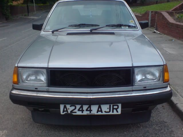

I acquired and modified twin electric fans for the 360 to replace the singular one I had modified from a Primera.
ATM these are mostly there for asthetic reasons, it fills in the centreless grille and is pretty 'hardcore' which is the look I am after with this car. Well I like them lol.
So I replaced the bolts holding the fans to their housings with long m6 bolts that go straight through the fins of the rad.
It seems I managed to nick the second core when I pushed the bradall tool through. Serves me right for not removing the bumper I guess!
It seemed fine when I fitted them but the next morning the system was bone dry! I refilled it and it was cascading out! See vid
The water spilling towards the back was caused by the header tank overflowing on refill. For a split second whilst on my knees I thought WTF is it coming out of there for. :lol:
That was taken on the way home, having made more water stops than a steam wagon and purchased an £11 bottle of KSeal that I may as well have (and did in a way) poured down the drain!
I looked/phoned around and wasn't prepared to pay the price for new/reconditioned rads but luckily FJ brought me over a single core 1700 340 affair that looked like it could be a goer.
It was then, after I removed the original rad that the hole was spotted.
Here's the video from when I leak tested it to confirm things.
Quite the boring post so far, right. :lol: I has m0ar.
I removed some of the surrounding fins and repaired the hole with JB weld. Let it set and leak tested again. All A-OK this time around.
So I refitted my fans (lol) and stuck it back in. Filled her up and took for a run yesterday evening/left it stood for hours and not a drop. :)
Used it this morning for a second stage interview and it is back to it's best.
I don't expect my rad and water pump to last all that long now, so If they bite the dust it won't be such a surprise!
I have never had a leaky rad before, and assumed that to have that much water flying out then the core would be split open by a large amount - I guess not. :lol:
As she currently stands. not to everyone's taste I know. lol

Re: Liam's Incontinent GLS *ghey update*
Post by volvosneverdie » 16 Jun 2010 04:35 pm
Safety grille FTW.
Fingers crossed she holds her water man.
Water pump might fancy being a dick like you say, but double fingers crossed it hangs on a while yet too.
L14MNP
