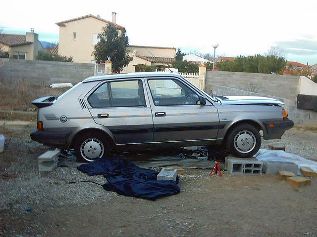

Nick C wrote:
A M R wrote:fook it, just find some big bricks...
I'm assuming you mean that in jest!
As there might be people on here who don't know - You never ever leave a car on bricks if you're going to be working under it, they can crumble, with obvious and unwanted consequences! The same with jacks, which can slip and let the car fall off.....
As the posts above say, axle stands are cheap, there's no excuse not to use them!
Just Do what I Did:
you cant see very well but theres a block behind a block at front wheels
I filled it with concrete :P 8) call it ghetto or what ever its been like that for several days and theres no way its going to brake or crumble i used high concentation :wink: hand mixed , in total it cost me 3 euros for 2 although i already had the stuff :lol: i also put little bars in to stop the car rollin off (just in case)
ali that car is da bomb its sounds sooo cool and the paint is sooo good!

Post by trabitom99 » 20 Feb 2007 10:56 pm
germ wrote:Just Do what I Did
Glad to see you've got a fair bit of space around you to work on your car - not that I'm jealous or anything ...

Post by germ » 20 Feb 2007 11:27 pm
i live in the south of france :P theres tonnes of room i think it used to be grapevine land. it not as much as we wanted anly 900m2 but its ok for now. we where going to get this place with 23hectares of land sereral out buildings and a relativly large house it was only ..and get this....64,000 euros sooooooo cheap for soo much but it was in the middle of nowhere :( thinking about it i could of had my own racing track :P .
any way this was about 5 years ago before we lived here so it was very cheap but now... its very expensive :( and we still have are house in england which we sould of sold but it hasent even been put on the market :oops:
it is a bit cramped there but at least you have wind protection :wink: which i wish i had so much . and another thing you dont have to lay dowm on sharp stones. so both have there ups and downs :D
