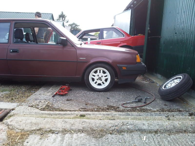

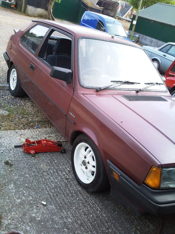

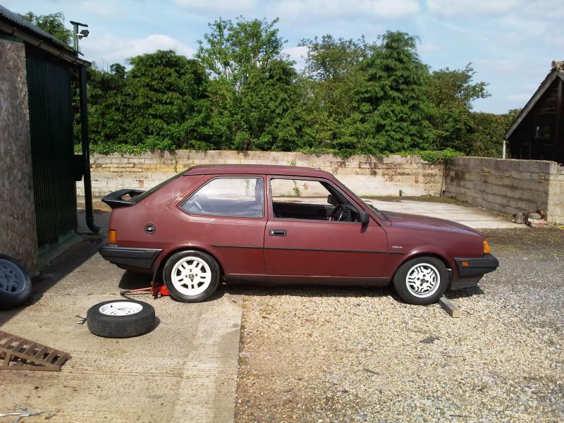

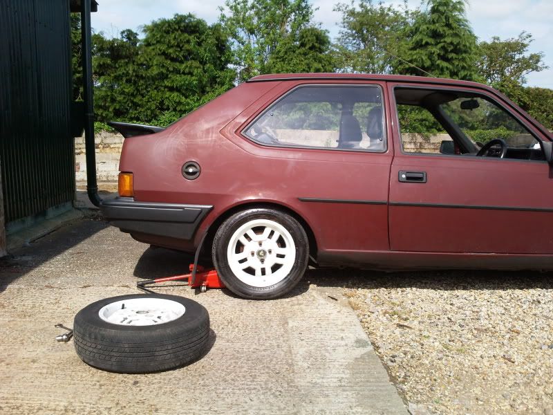

Post by Bazboy » 03 May 2009 12:13 am
Ok so as you may know i have started to refurbish the leo's i got from sven, I did a quick test fit with one today to see how it looked and i am very happy with it, this is not the final color and isnt the same wheel in the refurb thread, this is a quick job i did on one to get an idea for the color, and i am really tempted by white.
Enjoy
