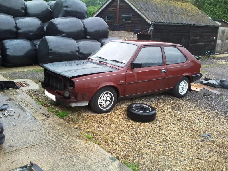

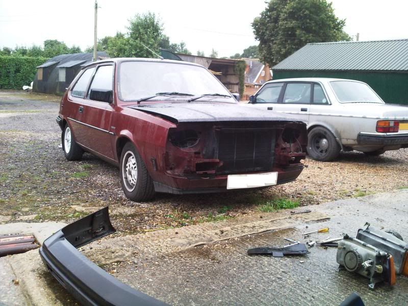

So today began the long but scarily close road to retro rides, so lots of work volvo wise :D
Plan is a respray in royal maroon with white stripe and leo's and a few other bits done, hopefully suspension but may leave it till after mot and rr as time is against me.

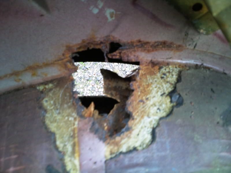

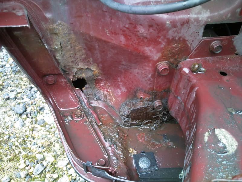

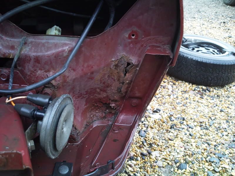

So today i started stripping the car in search for rust, and i wish i hadnt gone looking :lol: Its pretty crusty around the the drivers side rear wheel arch and very bad around the to front, mainly wing territory, so am umming and ahhhing about whether i should get rid of the mot failing rust, get body work great and spray, but leave the front inner wings untill i can afford new wings from volvo, as im working to a budget at the moment and the paint and everything else is bought. Or remove the wings and probably not have the car for retro rides :( .
Anyway on with the pics:
Front partially stripped:
Back almost done but how on earth do you remove the rear bumper???
Rust....
Rust.....
Horrible rust.....

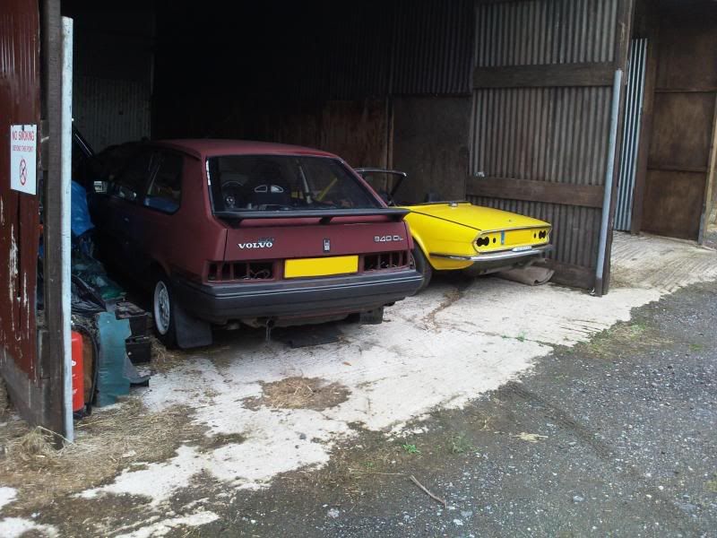

Looking pretty sorry for itself
Parked up for the night untill tuesday when i hope to get some more stripping done

Re: The rear inner arches. Rip all the sound deadening out to check for more - the metal is unpainted under the sound deadening so it can easily spread under there. This happens as the plastic plugs that go in the arch (you'll see them if you look up into the arch from the outside) fall out and it lets water in :(

All the rust on the front panel is the same as i had on my 86 340 mate and its not too bad to repair.
