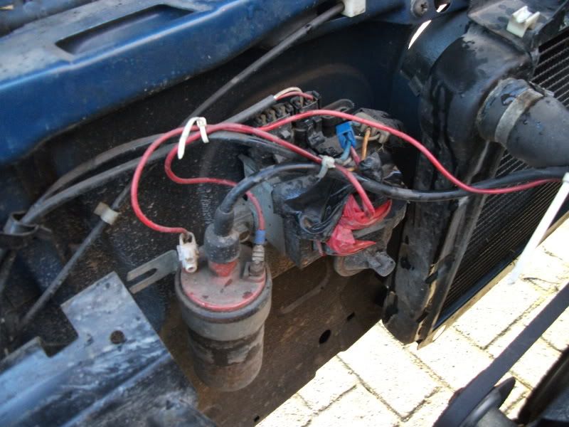

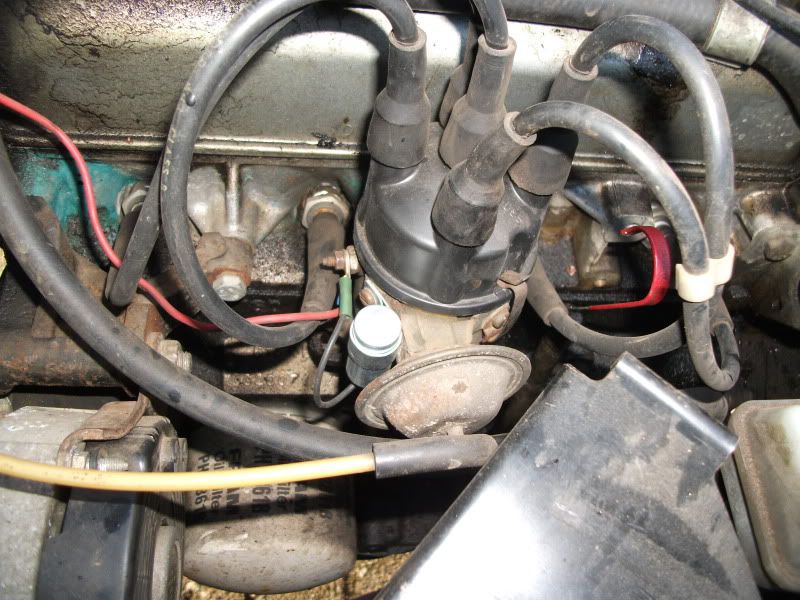

Not being clued up with B14 what's going on with all that wiring to coil???
Test on Thursday,good luck with that :shock:

Looks like the renix has died and someone's fitted a conventional coil.
Re: Bought a Winner :]
Post by MCHUDD » 03 Jan 2011 09:58 pm
Yey i was wondering about that one myself.

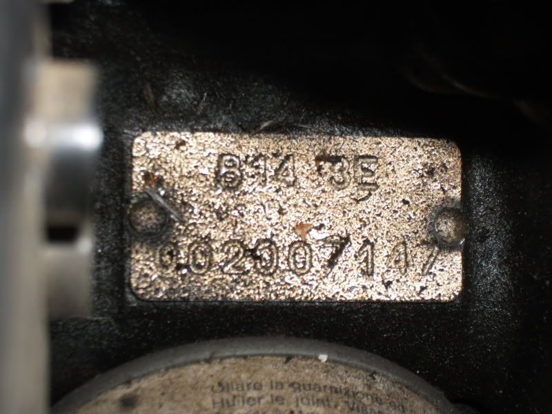

Wow, that's quick working. I'm keen to see what you get out of the detuned B14.3E :-) AFAIK a B14.4 downpipe would help too ...

B14.3 has a single piece cast-iron manifold wich includes the intake and exhaust side, exactly the reason why these crack all the time.
so you don't just need the B14.2E or B14.4E downpipe, but also both intake and exhaust manifold

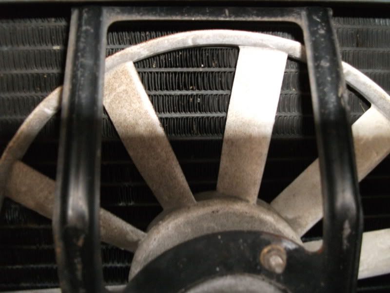

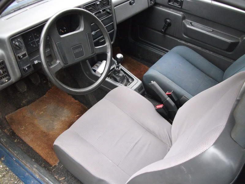

The original fan died with the crash. So I converted a sucking fan to a blowing fan.

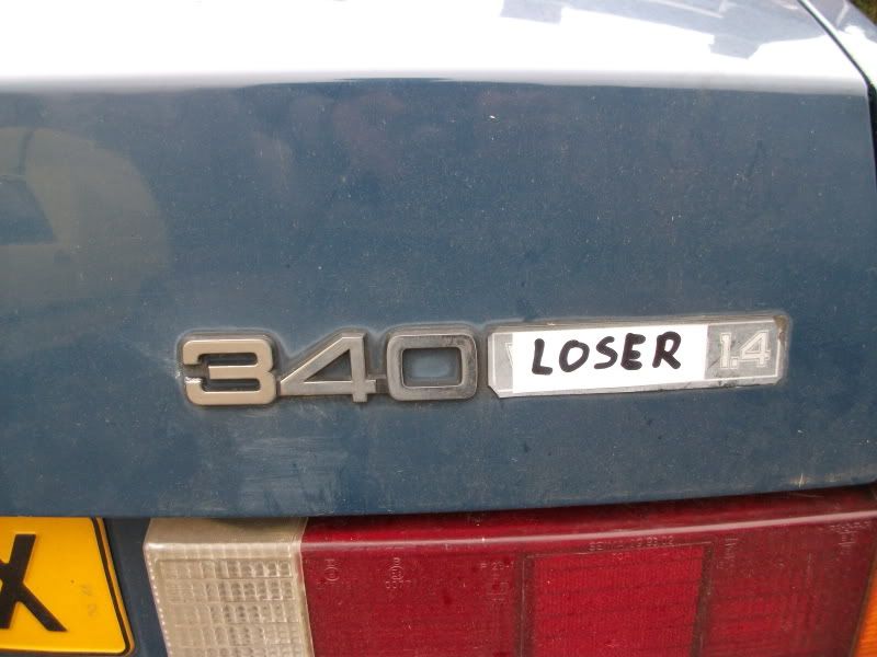

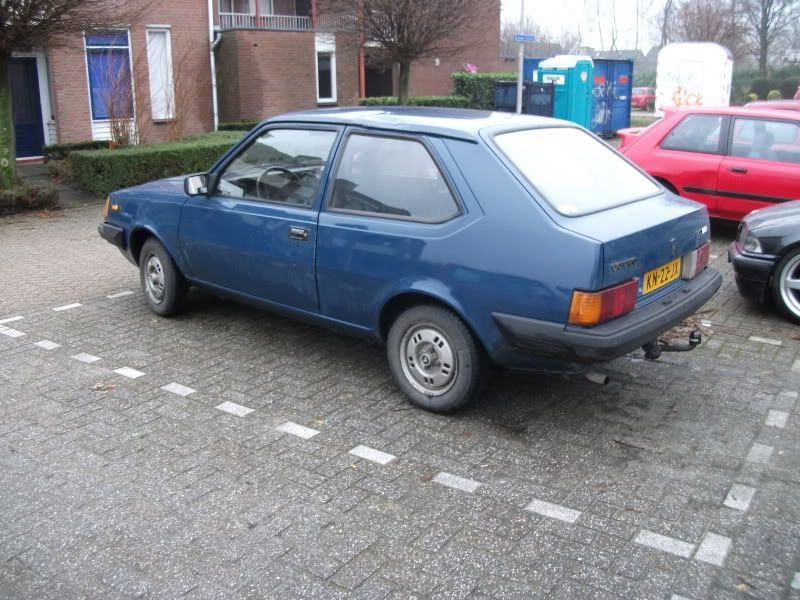

The garage guys renamed the Winner :lol:
The car's handling is great. Much better than a 360.

Post by theo2468 » 07 Jan 2011 06:30 pm
Never seen a dash like that before, love the car some times I wish mine was a bit ruffer so wouldn't have to be so nervous about nocking it.
Post by trabitom99 » 07 Jan 2011 07:20 pm
theo2468 wrote:Never seen a dash like that before
Completely knocked down Euro spec, "Winners" were "Juniors" in Germany ... Did all UK cars get clocks?
