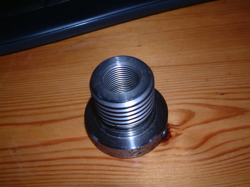

HI guys and gals, Ive been trying to get a thread insert (not volvo related!) retapped to a suitable size, ive been round the machine shops in selby and the college were i spent alot of years and no one seems to have anything the right size,
Im looking to get a 3/4x16tpi hole, re drilled and tapped to 1" bsf (10tpi)
can anyone help on here? I cant afford to buy a set of taps that ill only use once!I know a few people on here have a good source of engineering bits so if they could help out id be very grateful!
its the internal thread on this collar here,

Might be the cheapest way. If its's a through hole you'll get away with just the taper

aye id looked at tracey tools, the hole is indeed through but 40mm deep/thick.

its part of my new lathe, its a spindle thread adaptor.
external (m33x3.5) goes into the chuck.
the internal thread, currently 3/4x16tpi, needs to be 1" bsf to match the spindle thread on the lathe.

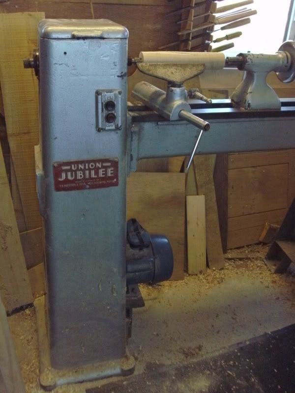

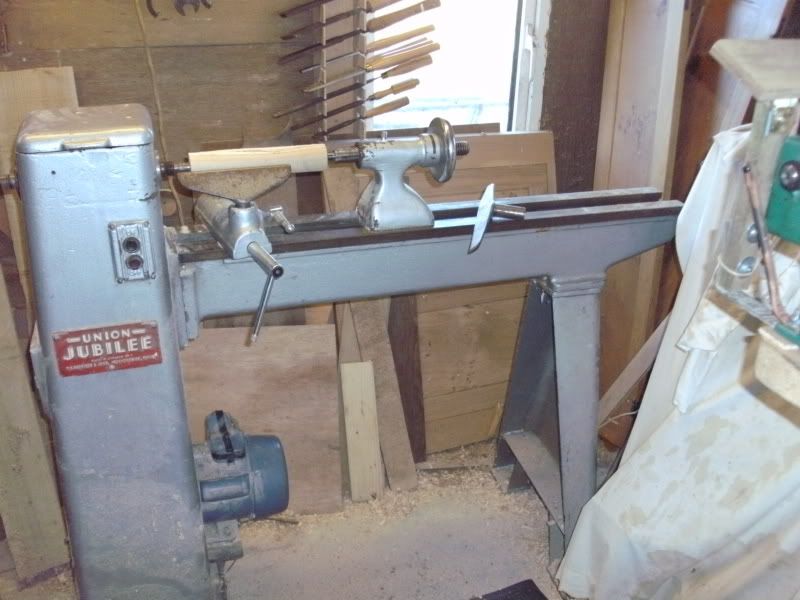

new lathe -
definatly dont want it coming off! top speed 2.9k rpm also could to with a LH threaded one aswell!
