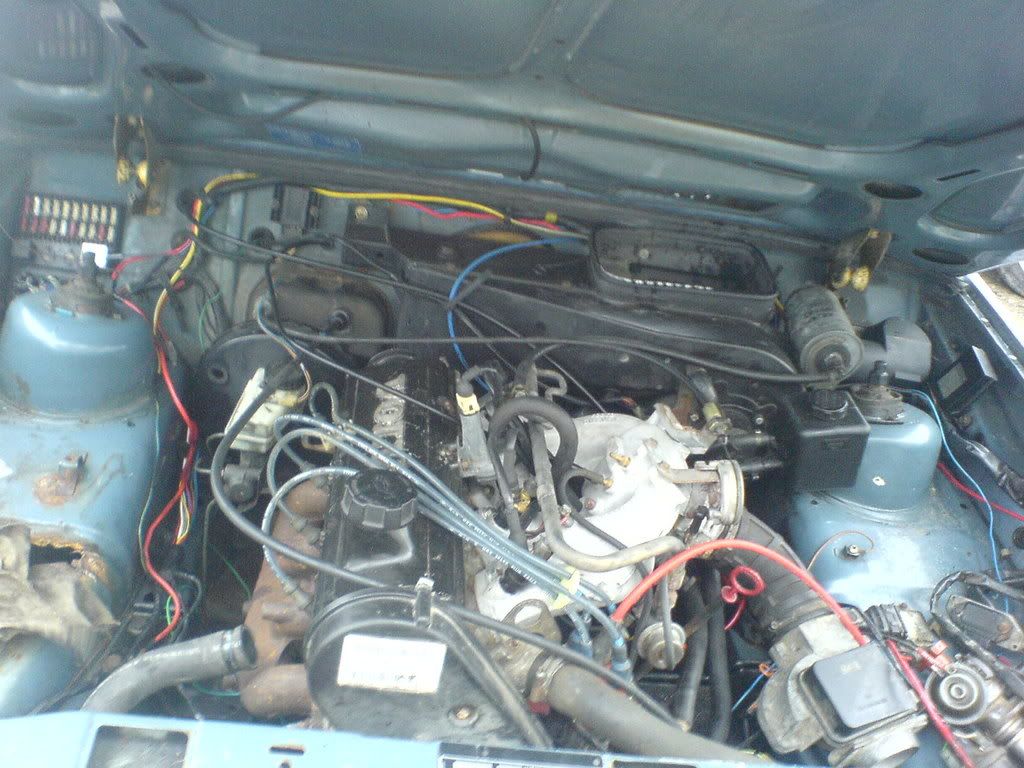

I have progress on my 340 with 2.3 power.The engine is fitted
http://i170.photobucket.com/albums/u265 ... C00217.jpg
but my power steering rack which has done about 6 road rallys has exremely sloppy inner ball joints.Does anybody know if they are still available to buy new coz mine will definatly not pass M.O.T.Also i have put an entry into a local rally,Rali Bro Tiefi.It starts in Cardigan West Wales and has daytime selectives and night time selectives on the 11/12th April which is my deadline to finish the car,and was wondering if anybody would be able to marshall for me on this event.There is also a day event which we enter every year called Classic Tracks.Its a brilliant rally which really tests the strength of the cars that enter and every year more Volvos are entered than the last(Is that saying something or what).We may also need a marshall for this one too.It is useually in the last week of May,and is based in Llanybydder, Ceredigion,West Wales.So if you would like to see some real tough rally action with 300 series volvos then come along,or if you would like to enter give me a PM and we can sort something out.Cheers boys,gotta go the Rugbys on,Triple crown here we come.

I am also in the middle of a rally car project which consists of a 340 1.4 shell which I have fitted a 360 diff box and torquetube.I have a 230k block with 13mm rods,flat top pistons,530 Head portmatched and slightly polished,740 turbo manifold and throttle body.It has a Kent Cam L4 profile which needed landrover discovery lash caps(top hat shaped caps which fit on top of the valve stems)and machine shop made valve shims to get it to fit,adjustable cam pulley,240 electronic ignition system and the original injection system with 740 16valve injectors.240 flat flywheel,uprated pressure plate and bespoke twin paddle sprung clutch plate.One of the best upgrades i did was have a downpipe made to fit around the 240 power steering rack but it does'nt fit now coz i have gone back to a 360 PAS,it made a noticable difference to the power.And a 2.5" straight through 2 box exhaust system.The white GLT it was in before used to absoloutly fly.I reckon a conservative estimate on the power from that engine was about 160-180 bhp but i never had it on the rolling road to find out coz my missus wrapped it up flat in 3rd.OOOPPPS!!!!!!!!
