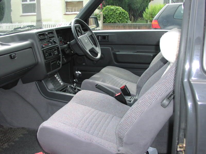

Post by tommysb » 22 Dec 2008 01:54 pm
Got some pics of it....No Power steering.
The plan is to take it on this http://www.sucatarun.com/ then modify after that.

Post by 340GLT » 22 Dec 2008 02:08 pm
Thats by far the best colour on a 300 IMO!!!! lol
