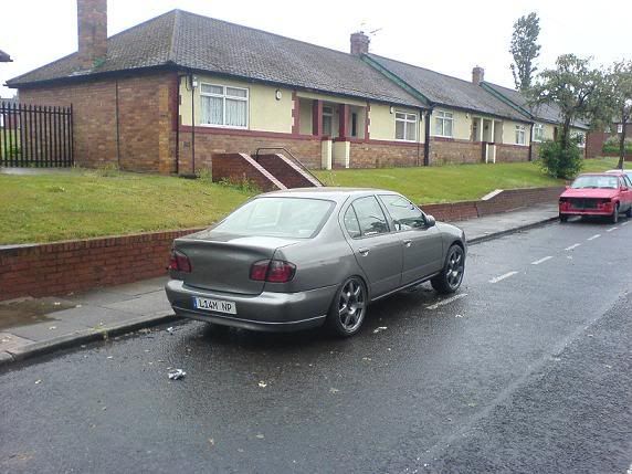

Here's the WIP for my 1998 Nissan Primera for those that are interested. I've owned this car for over 8 years, it started out life as a 1600 Si and has had various 1600 and 2.0 engines fitted to it as well as numerous
parts from higher spec and newer models etc.
The last engine developed rod knock and my DIY smoothing etc. was starting to let the car down so I took it off the road.
For the last 4+ years it has sat in my garage in various states of build. The reason it has seen less daylight than the Fritlzel family is down to a few things. The main being the SH1T paint job it has ended up with.
The car is originally silver and I wanted it a brighter silver. Decided on Aston Martin Titanium, acquired the paint code from the AM dealership and gave it to the painter who then told me it was wrong and that he/
paint supplier would sort it out.Well, he got the wrong colour altogther. The car is now Aston Martin Tungsten 'silver' Like a greeny gunmetal. I was told I would have to pay for the paint if I wanted it a different
colour (£280 iirc) We sprayed a panel up and I decided it looked pretty decent and I could live with it - first mistake!

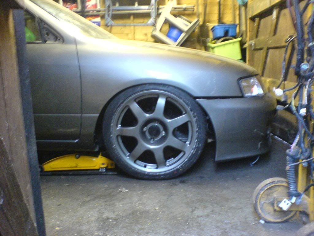

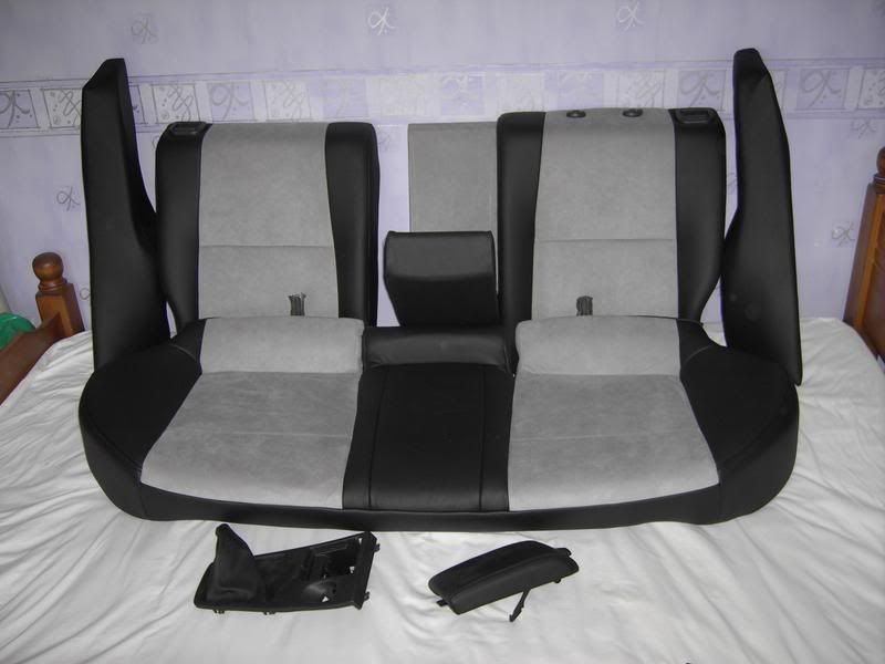

I decided to modify the car to a sort of euroish/luxury style so I had an interior retrimmed with Subrau Impreza front seats, sourced a load of rare JDM parts, new headlamps, folding mirrors, crystal fogs, already had 18" Raceline RL7's, Skyline GTR 4 pots, brand new SR20 engine and box, new coilovers etc and had my doors smoothed and previously fitted facelift boot/lights/bumper smoothed (was never happy with the back after this) wings smoothed, a new bonnet smoothed again and front bumper plastic welded smooth - all done by a proper body shop a panel at a time.
I started to build the car back up, engine in etc and the more parts I bolted on the more I noticed what a mess the paint was. I made the decision to strip it and remove all the underseal and paint it up body coloured underneath/inner arches and clean up and paint all of the running gear.
I also thought it would be a good idea to smooth my engine bay (why!?!) so a lot of time has been spent making a hidden loom and plating/fillering the bay – I gave up on this when it got cold lol.
Then one day something inside me finally gave in to the urge to make a Super Touring inspired stripped and caged fast road/occasional track dayer.. It’s a combination of things (Johns pics being one of the final straws lol) I was worried I would end up with a shonky ‘replica’ but I have no plans for the livery and I am not really copying the car as it’s next to impossible. More like acquiring the bits I like. I would never have been happy with the car unless I done this to it, now it’s something I can add to/develop in the future IMO.
I intended this from the start hence buying the Racelines but my dad put the brakes on the cage and I never looked into it any further as he is the master fabricator lol. I bought and sold an ex works carbon fibre front splitter and reluctantly went with the now abandoned ‘euro jdm’ look.
Here’s how it was destined to look until I finally saw the light (barely got any pics)
And a few parts of the interior.

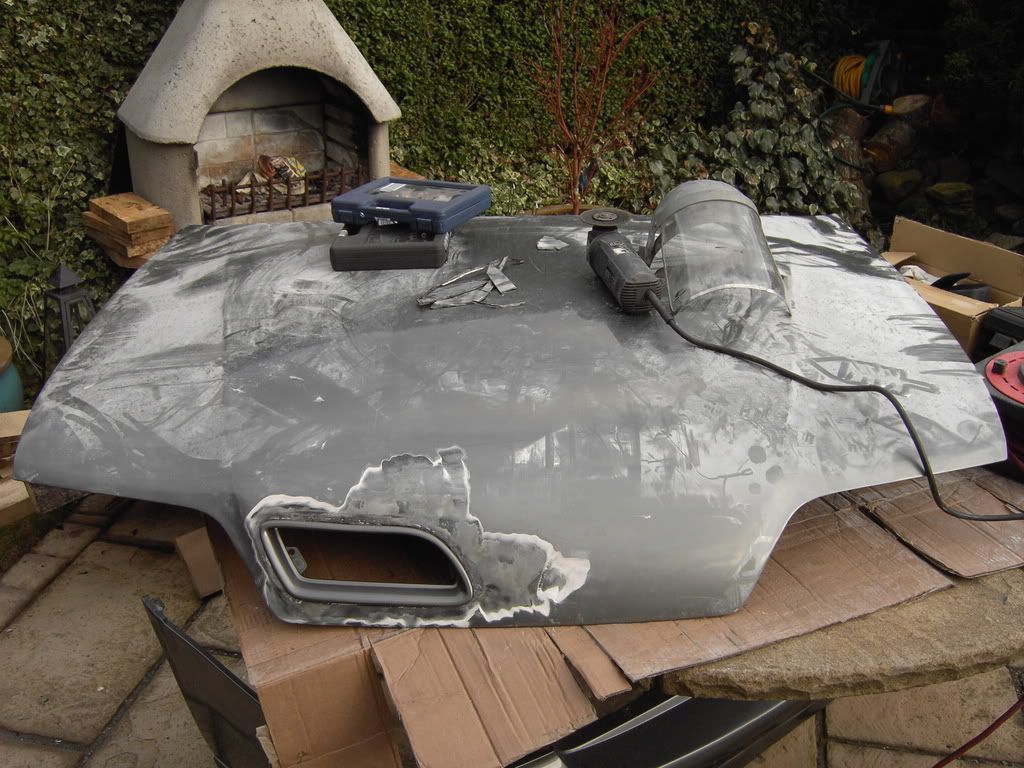

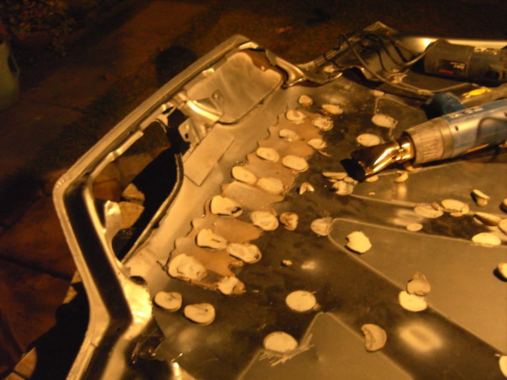

I tackeld my bonnet on Sunday afternoon, cut away the bracing from the centre and the reinforced slam panel/bonnet latch area.
This was mostly just to see what it turned out like as there was a high chance the bonnet is scrap. I had the grille holes welded up about 4 years ago lol (you'd think I'd learn after my first!) The metal used was about 2mm thick so a bit of a trial to remove and reshape but having done one side I think it will work out OK.
I'm glad as the bonnet is an OEM job and has never seen a single mile lol.
Here's a couple of midway pics - just bought a 3" air cut off tool to finish of the edges etc. (Dremmel broke)
As it was
Typical those plates are spotted on so well!
Mmm lovely
Bodge removed
One side cut back out
How I left it
There was no real need to cut the slam panel area out but it's made a massive difference and the bonnet is still rigid enough, also it will be held down with aero catches so there's no harm in it.

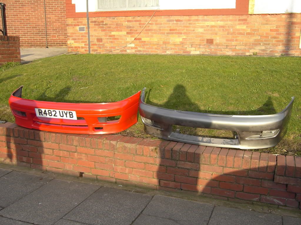

I also parted company with my front bumper tonight, sold it to my mate and fitted it for him outside mine. It's the least I can do given that he's 90% wanting my interior and he's buying my facelifted parts - bootlid, rear lights and rear bumper as well as giving me his standard original stuff lol.
Alongside standard P11 GT front bumper
Paint and lower plz!
I'm gonna miss that bumper, but glad it's gone to a mate. Will look the business with the fog covers on and a nice FMIC or more likely some black plastic mesh lol. Although I've had it done years at least it's a very popular style ATM (rear end too) which are handy plus points when selling!

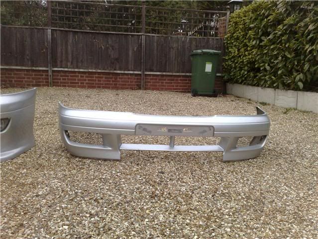

I'm negotiating a bumper ATM, some guy on NPOC has it. It's a genuine works splitter but has been mounted to a cut down bumper by the previous owner and something isn't quite right about it. I await more pics but that's the style front end I'll be running, either from him or Touringcarspares - when he eventually gets more in stock!
I'm not sure if it's been smoothed in at the bottom and the fact the car it's on looks dodgy, gay black centre and has front fogs doesn't help IMO lol. I'll have more of an idea when I see better pics - off the car, seperated etc.

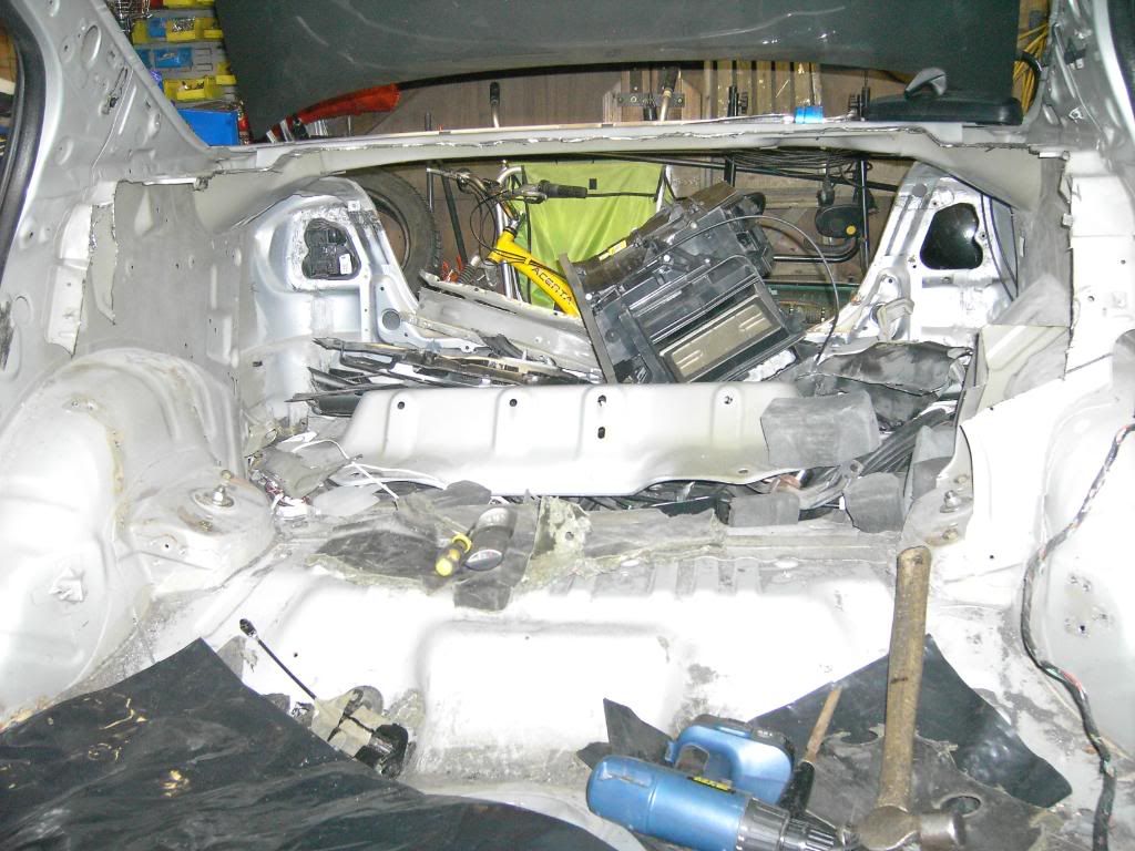

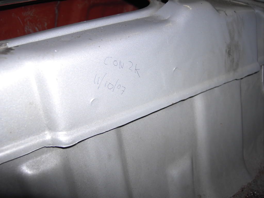

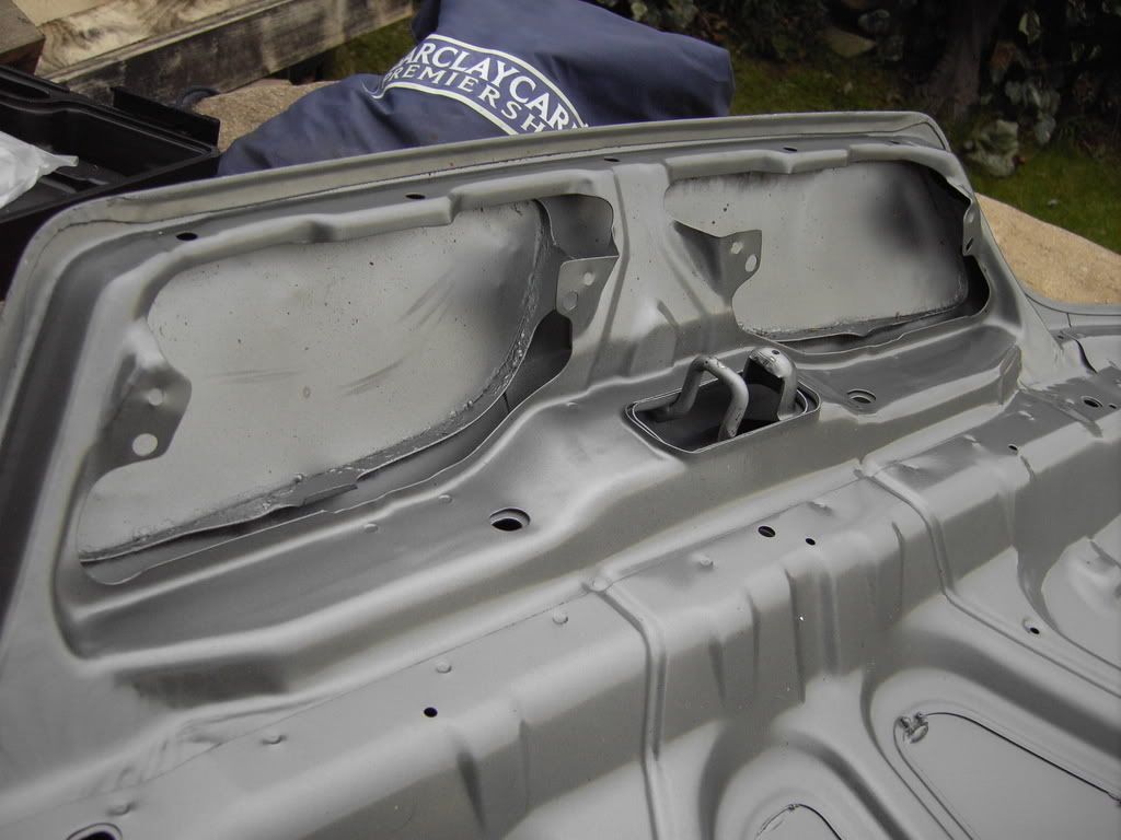

What a difference a decent spot weld drill bit makes.
Worst smelling sound deadening ev0r
These brackets are coming off so much better than the engine bay ones did. Still made a couple of holes but it's OK. The steel the car's built from is thinner than the veil of privacy surrounding Jade Goodys daily trials lol.
The junk in the trunk.
If this was anything other than a Primera I'd be able to sell all this lol. Ah well, pretensioner might go well on a fire lol.
Check me waxa 6x9 holes and fibreglassed aerial hole lol. The shelf will all be getting cut out anyway.

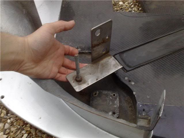

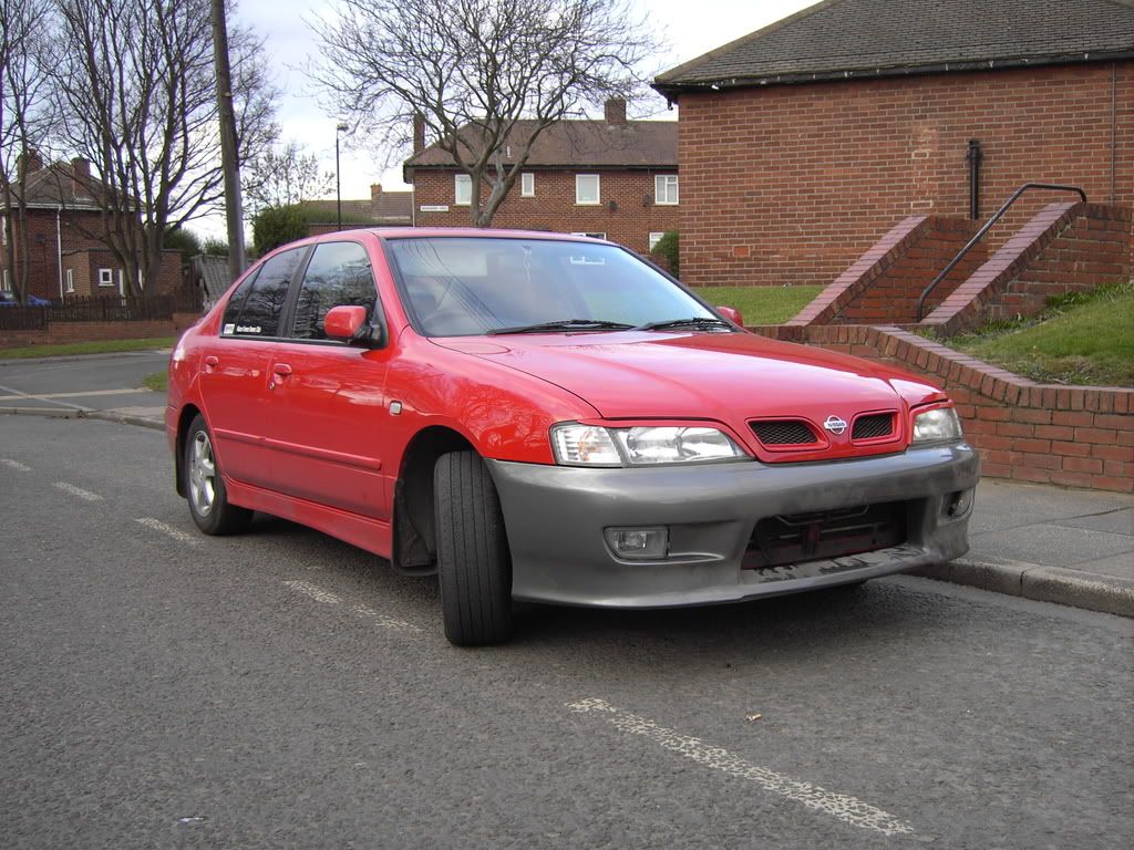

I have sorted the CF splitter too, spoke to the lad and just waiting for my mate to collect it in 3 weeks time.
Still not happy with the bumper - especially the fog cut outs. I will more than likely get another and adapt it myself. Happy with the price considering the availability though and yeah of course I tried knocking him down further!

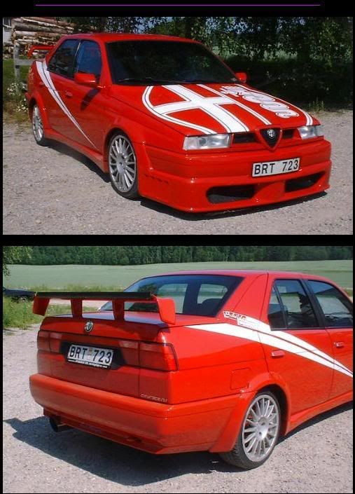

After many hours Googling I came accross the PSG Zero G BTCC replica of the Alfa 155 kit from 1994 (^above^) PSG are bust now so I rang around and can get it, although only in FG and it's custom made. Works out about £180 delivered - so I'm unsure on that as I reckon I can get an ex-works CF one for similar money at the right time.
I found out a lad from the Volvo club bought his shell (the 360 from PPC magazine) with a BTCC works Mondeo spoiler attached and asked if it was for sale.
Turns out it’s GRP though and I ideally want CF.

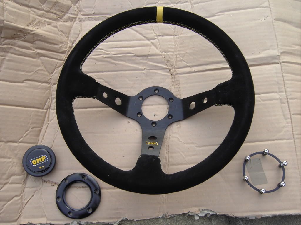

Picked up my OMP dished suede wheel from a sound lad on the pipe n slippers forum at the weekend. Best steering wheel there is IMO. Got a sweet deal on it and it's brand new. :)
I have a mk1 Fiesta boss lying around from my previous dished wheel so have fitted it with that for now, it fits and works as it should but I'll still get the proper one along with a snap off boss.
Fitted to the car to see what it's like. Aside from the dash loom pedal box and steering column it's pretty much devoid of the essentials still lol.

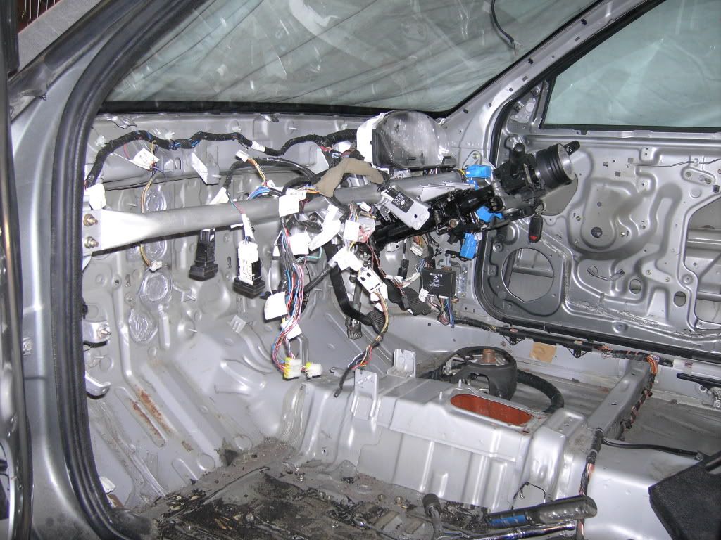

More unwanted crap removed, dash sound deadening, heater matrix, front seat bars, some floorpan deadening (what a pain in the arse)
The loom, modified heater box etc. were only refitted a few months ago. Would have left it all out had I known lol

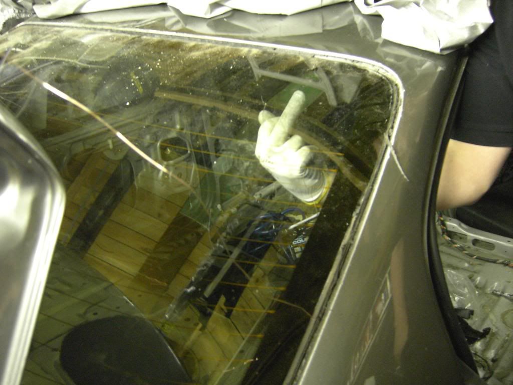

Taking my time with the spot welds for a few reasons. Access is only possible on one side of the car and it's 3 feet off the deck, it hurts my old joints and I don't want my floor full of holes lol. Slow and steady FTW.
Only just noticed this lol
And the days fail :lol: Thought I could smell something!

You can see where I heated my hub carrier to get the 0.5mm clearance needed with 225/40/18's (ran 30's before) this has also rusted lol.

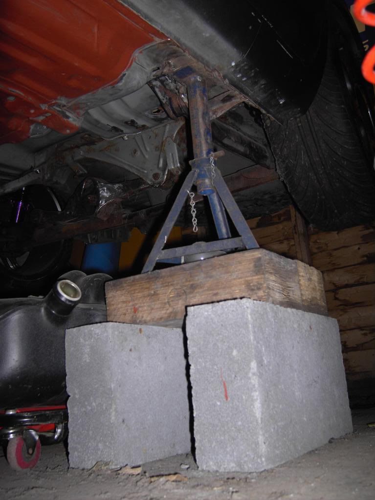

Been busy lately so not had much time for the car as been helping a mate with a poorly Pulsar and raking about in scrap yards lol but got a bit done still.
Lowered it down and turned it around ready to move to it's new home lol.

Removed the rear window with the help of Mick. The outer seal is rigid plastic so about four layers of Stanley knifing later the bond was visible
Pro as you like bond cutting. MiG wire FTW
Out
Place with care on soft ground and at a safe angle
Owned! Fuck knows how this happened, must have nicked it? As can be seen, it never fell over lol. I don't need it but wasn't about to smash it all the same!
I really hate 6x9's lol. Going...
Going...
Gone
Now the joy of removing the left overs and not turning the car into a seive with the spot weld drill lol
This gives an idea how much has been removed. There is another massive heavy piece that bolts on (not in pic) that bolts around the outside of the hole for the boot.
Picked this up at the weekend too. Citroen ZX setup. Seems to be pretty close and will have a good sweep/the opportunity for variable speeds. We shall see later, couldn't say no for a fiver at my favourite scrappy lol
My mate collected the carbon fibre STC splitter for me too :) It will head off to another mate to be stripped to bare carbon. I need to source another poverty spec bumper so I can adapt it to suit the splitter and not look totally gay like the last owners attempt!
Looks better than the one I had previously
Nice deep under tray and better brake cooling ducts FTW.
