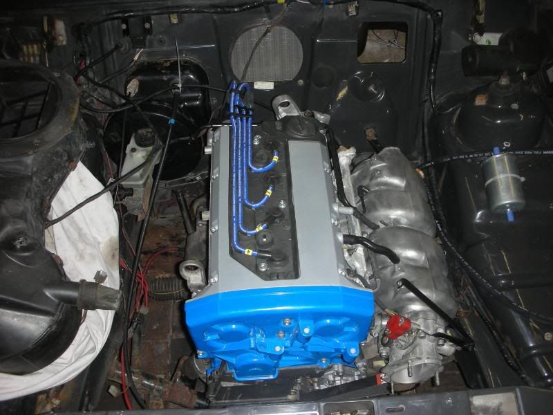

Re: Some Volvo 300 questions from a noob if you don't mind:)
Standard 1.4 with heaterbox under windscreen:
Valver conversion with heaterbox removed:
So thats what youve got to work around mate.
Hope that helps a bit man.

Some notes on that: Your first pic is a MK2 heaterbox. Used from '78 till '85...MK3 has another kind of heaterbox. And second picture is Adam's white car. I think he just took the box of for installing the engine, as he already has the rewelded inlet manifoldvolvosneverdie wrote:Standard 1.4 with heaterbox under windscreen:
Good one on the fuel-pump btw. Forgot that!
Flipped inlet manifold, courtesy of Adams amazing aluminium welder. No heater box in pic, strangely don't think i've got any with it all in there.
* Edit- so basicaly the same as VND already posted
