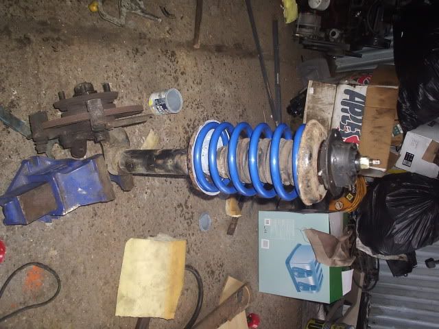

Good Friday I removed front shocks welded up the broken spring cup and fitted some stiffened lowered coils, greased strut top bearigns etc, dechromed the front grill, and gave the front wings and bonnet a quick polish up.

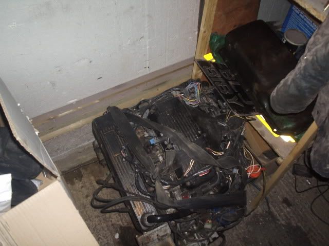

the V8 engine waiting to go in...

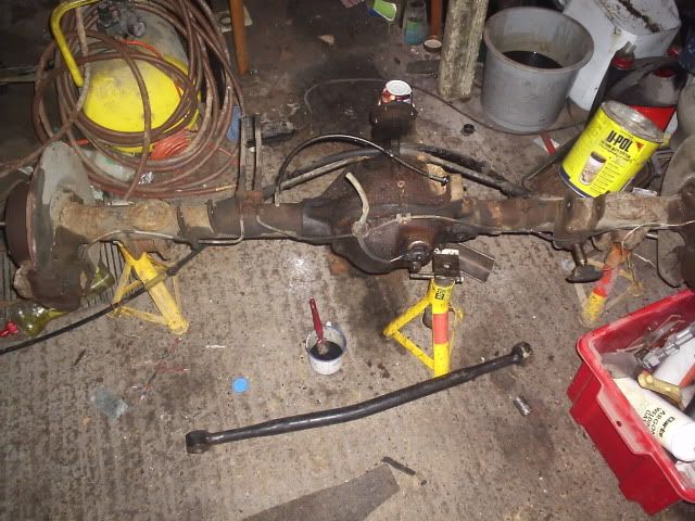

240 axle waiting to be refurbished......

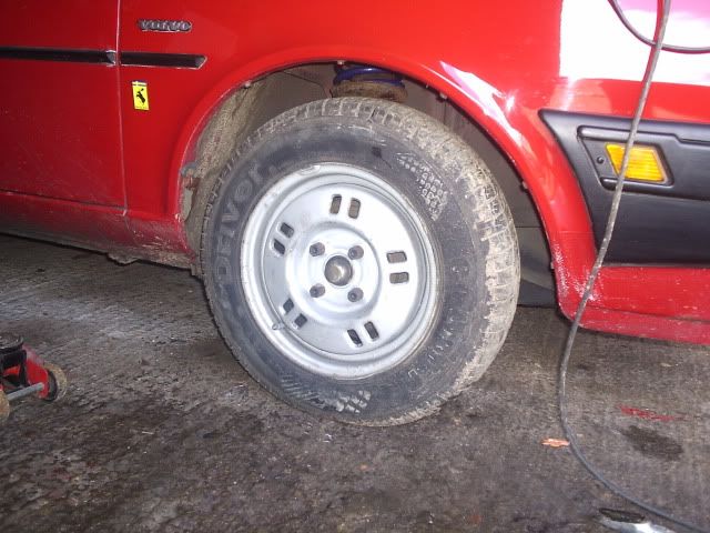

a bit of lowering taking place
car after being lowered (doesnt seem much different)

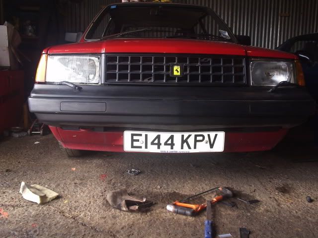

dechromed grill......

Re the "it not looking very low" i had similar thoughts when i put my new springs in but i'd take a guess it was on its 20 yr old or so original springs and they will have lost some of their spring over the years so will be sagging a lot making it look lower than it should. They may well settle down a bit aswell once you get some miles on the new springs.

You might want to look into 940 '1041' axles as these have locking differentials (below 25mph) but you can modify them to lock at higher speeds too.

Usually the front springs are a bit sagged so mounting new lowering springs usually does not really lower the car...
I bet the V8 lump and gearbox will lower it quite a bit though.
