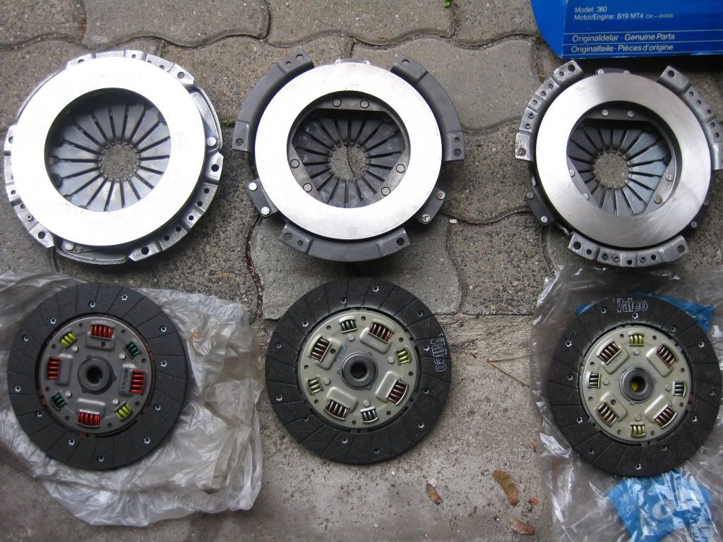

Post by trabitom99 » 11 Apr 2010 08:39 am
foggyjames wrote:...but if you saw the two flywheels and the two PPs together, it'd make perfect sense...
From right to left:
B19A CH -810500 MT4 pressure plate (4spd B19s from '81 to '83)
B19A -'83 pressure plate (presumeably 5spd)
B200 pressure plate
note how all the clutch discs look the same.
Did '84 B19s have a dished flywheel as well? If so, the PP on the left would also fit a '84 on B19.

Post by foggyjames » 11 Apr 2010 11:35 am
I'm not exactly sure, Tom. There certainly were "plain" flywheels (i.e. with no timing marks), so it's possible.
I'd have said, off the top of my head, that the "4-spd" and "5-spd" clutches you have there actually are the same...?

Post by volvodspec » 05 Sep 2010 06:08 pm
i just nozed over a piece of usefull information that makes a bit sence out of the 2 different pressureplates for the B19
with the introduction of the 5-speed M47R gearbox:
- for the MT5 models, the flywheel was made heavyer
- for the B19 MT5, the pressureplate is changed
- the clutchplate for the B19 MT5 remained the same
so the pressureplate for the MT5 is different from MT4, but i bet you can use the MT5 on a MT4 flywheel and vise-versa.
