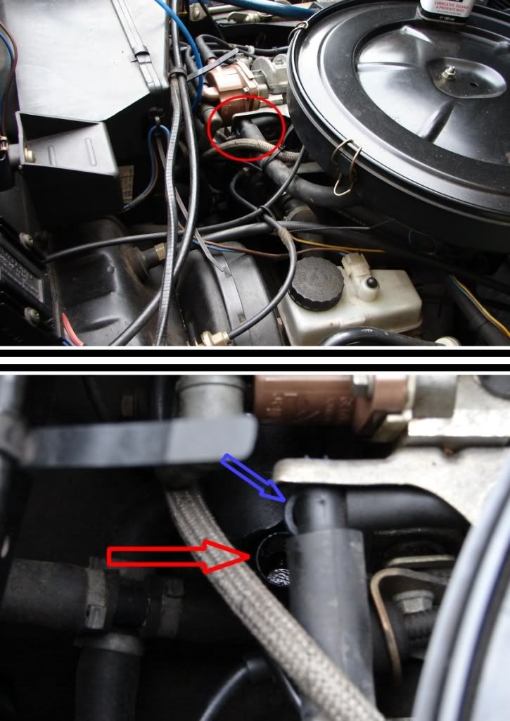

A picture paints a thousand words, so here we go.
There’s a rubber hose that runs from the oil separator, round the back of the engine under the distributor cap to a junction with two other pipes. At this junction there’s an L shaped plastic connector piece which pushes into the aforementioned hose, and connects to a junction piece. The red circle shows the relevant area.
Anyone have a spare one of these, as mines split and keeps disconnecting? (See the red arrow.) I could bodge it together with a cable tie and some duck tape, but a non-split part would be better.
If the same person also had one of the blue clip thingies (shown by the blue arrow) I wouldn’t mind that as well, as mine now only has one leg :|

I obviously didn't explain very well - neither Chris :lol:
In the end of the rubber hose, there's an L shape connector that's pushed into it. It's this L piece that's broken. It then connects to something else (which I think is the T piece your referring to.)
If you look at the bottom pic, you can see the rubber hose (under the blue arrow), and the L shaped piece is the bit you can see into the top of (as it's disconnected in that photo)

Ah ha! I see what happened here - thanks Chris :)
The hose under the distributor and the L shaped bit were the wrong way round, with the L shaped bit connected to the T piece and the hose connected directly onto the oil separator. No wonder it kept coming off! :P They do fit fine either way round though!
I took the hose off a week ago or so to look into the problem, and I'm 95% sure that I put it back on the same way round as I found it. I've found a photo from 2 years ago, in which you can see the L shaped part on the right end, so I guess it must have been re-fitted wrongly by a mechanic. Would they check these hoses aren't blocked in a service? Maybe it was taken off to get at the distributor better, but I don't think anything has been done to that for a year or so - maybe I just didn't notice it.
I expect the L shaped bit cracked due to the stresses on it from being connected wrongly.
