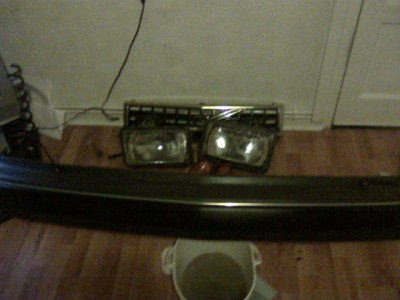

So onward:
Polishing the headlight reflectors and 'do' the brake lines, bit of detailing going on too:

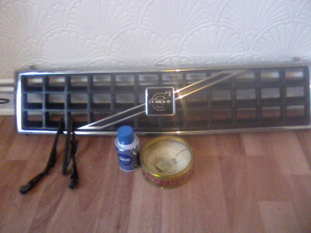

Post by CBA » 16 Jan 2013 04:28 pm
really want a prancing moose or mr.horsepower :D
Simoniz and Silv-O.
