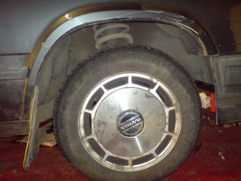

from this sort of height:

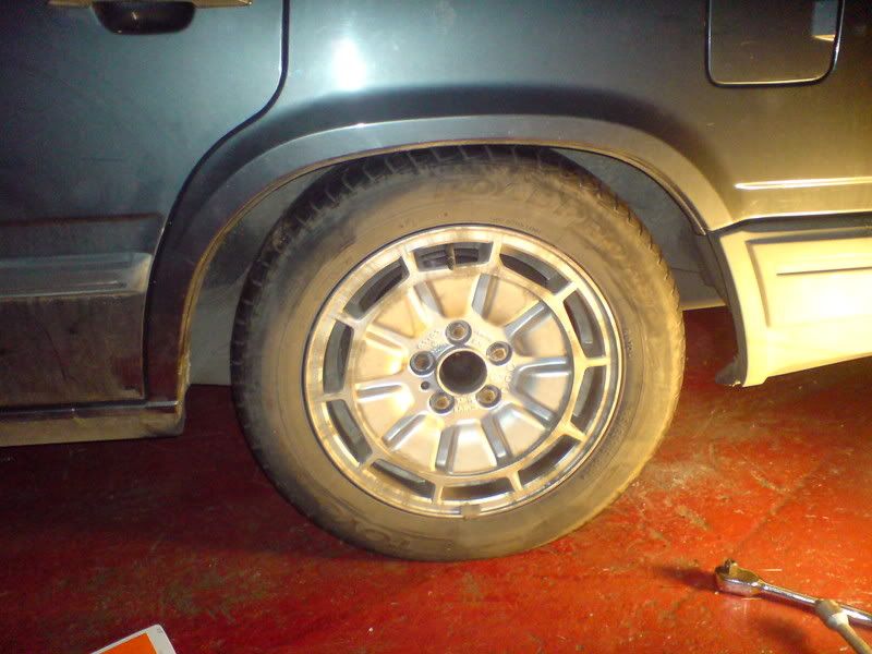

to this sort of height:
using this sort of behavior:
That'd see your front end lower for almost no money, and at the back you could use home made wood or metal lowering blocks with appropriate size bolts from B&Q. Better to do it properly, but it can be done almost for free.
