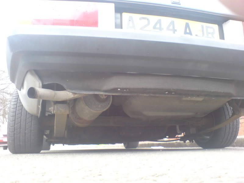

as I always intended running one (before FMIC) for a few reasons, but I'm not ashamed to say the main one was looks. lol Since the front now looks pretty mean (for a V300) I have turned my attentions to the rear.
There's reasons other than weight saving for why I have removed the wheel well.
Following on from plans to make the car look a bit tougher and more purposeful I wanted to mount the cooler in the rear valance (thermo sandwich plate/lines will run to engine) and expose the running gear when viewed from behind. Due to the saddlebag type fuel tank being in front of the axle/over the gearbox this means that the diff/gbox are now visible without the spare wheel well in the way and my back box can be tucked much higher up. The valance has been cut level with the bottom of the bumper. This would be more noticeable in it's absence on another car, but mine was painted in black underseal instead of being body coloured.

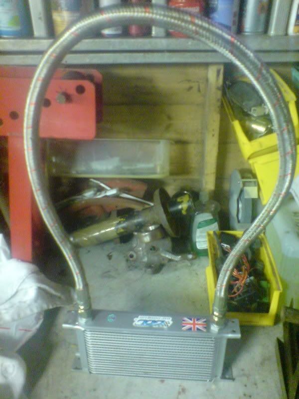

Cooler cut into bumper and valance with (currently rusty oily bits visible) . Should look pretty trick with a couple of nice shiny elbow fittings lol
Still yet to decide on the oil cooler angle. It's cable tied up in those pics. It will get plenty of cool air there and as my mate suggested, fit a guard over the inside face to protect it and all should be well.

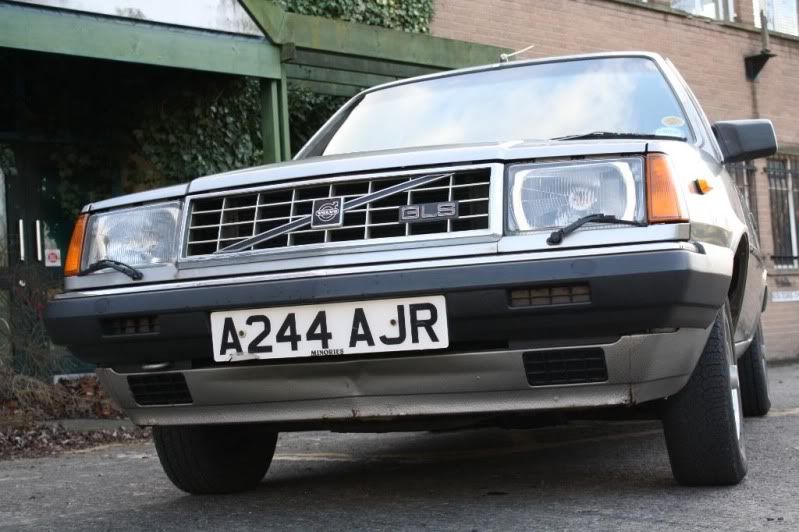

I fitted the oil cooler properly the other day and not content with ruining the rear bumper I have been hacking my front bumper about too, lol

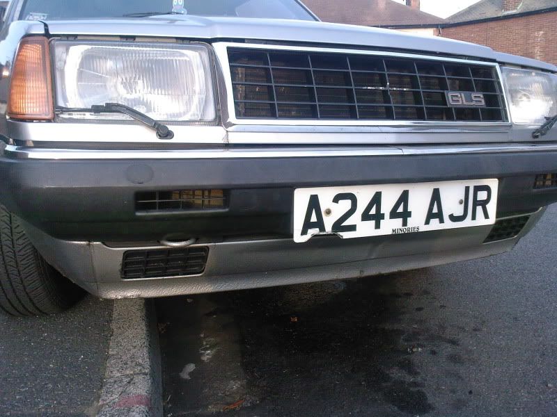

It used to look like this:
Note the blanked off grilles that cool the gearbox on autotragics. I cut the reinforcer out and opened them up. Can't hurt right? Looks a bit more agressive too IMO.
Leaving this:
As the grille I made is open, just the frame TBH, and the oil cooler being cut into the rear bumper is of the same style I thought I would cut those grilles out completely. As well as the area behind the number plate. I had to grind the reinforcer in situ as removing it would mean destroying the bumper. It's a bit close for my liking in some places! lol

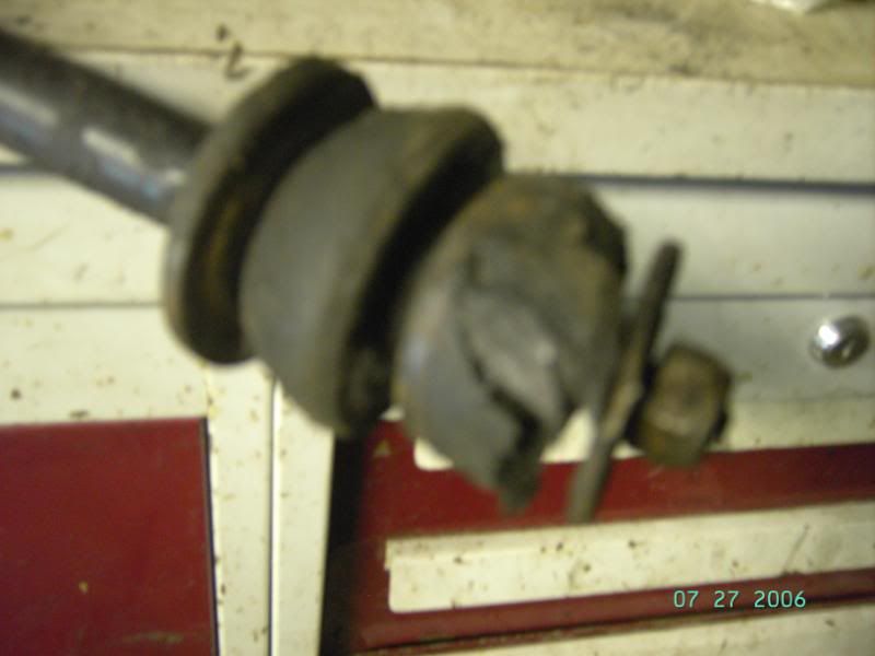

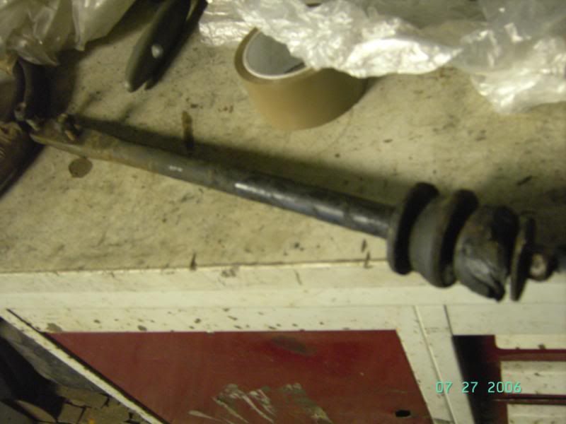

Anti-tramp bar. The chassis side bush had disintegrated.
As was the trend with the leaf spring bushes, the bolts were rusted to the bush. Fun. Changing the leaves for stiffer and inch lower variants, this will also correct the sag I had on the O/S/R.

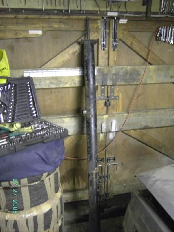

Torque tube

O/S/F tie bar
Nice bush.

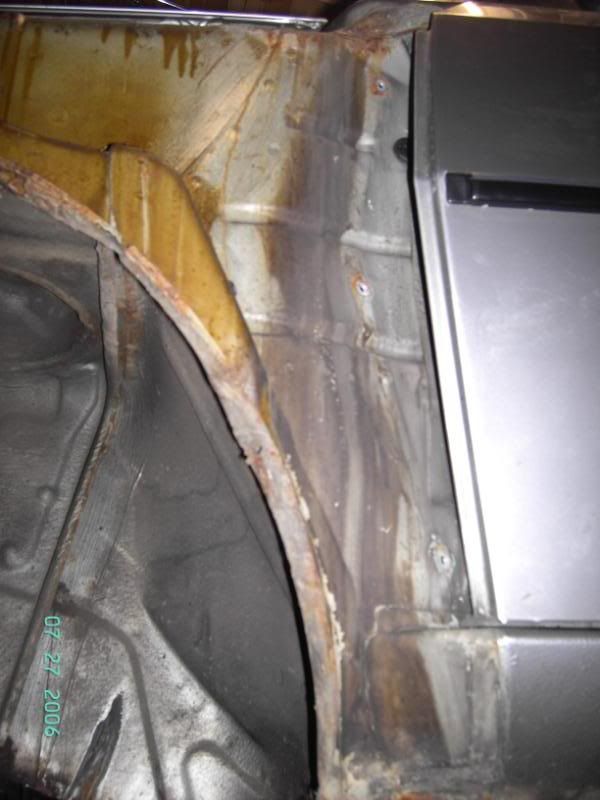

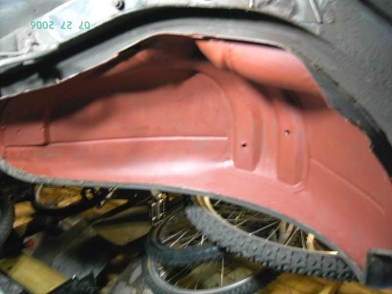

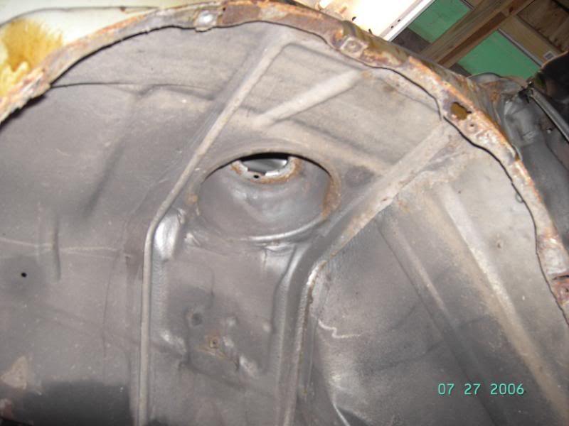

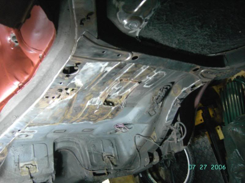

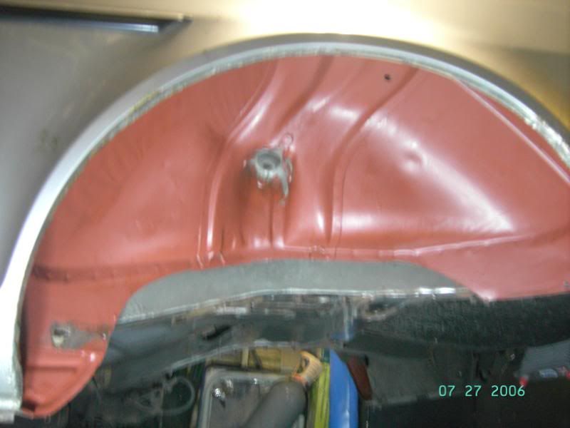

N/S/R inner arch
O/S/R inner arch.

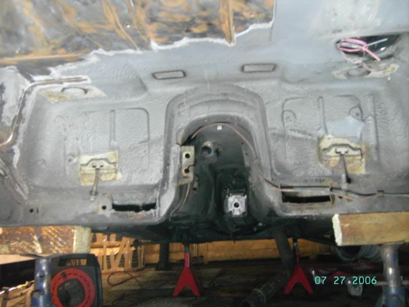

A quick pass with the grinder... These are just blanking plates to cover where a 340 gearbox would mount. Easy to remake.
Cleaned all of the rear box section up and a section of the rear floor but didn't have any red oxide primer at the time and it surface rusted again in no time lol.

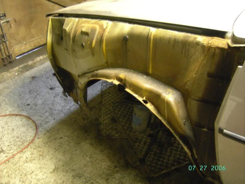

Front end. After wrestling with the wing, it was off. Time to assess the situation.
Not bad. Seen pics of much much worse!
Wings are for the scrap pile.
