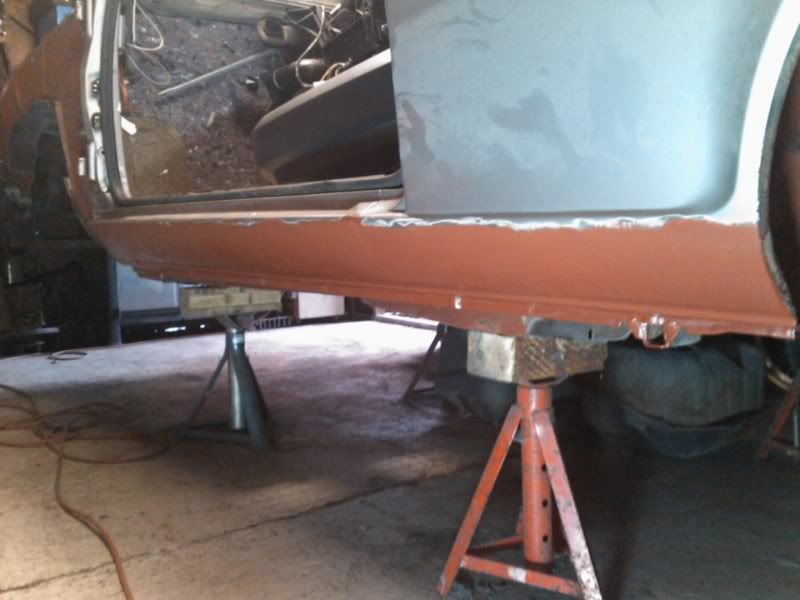

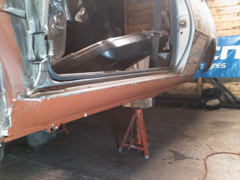

So I had a couple hours on it today, and here's where we are now
Not a lot to see really. The spare wheel blank is from the roof of my old Nissan. A part of it shall live on!

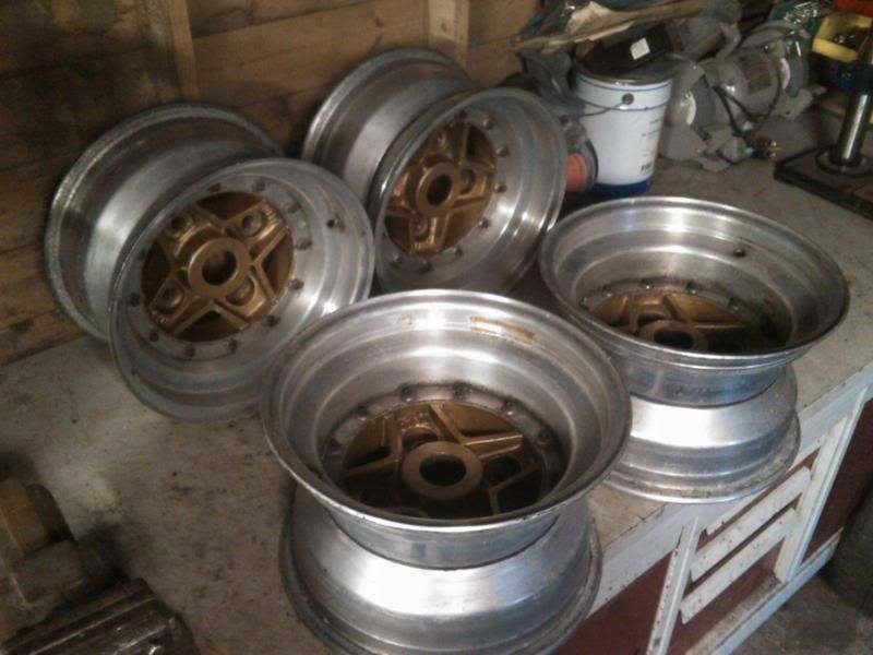

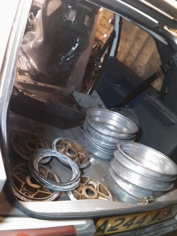

I also bought it some new shoes the other week.
I have them currently split, have started to refurb them and am awaiting new bolts. The original bolts weren't in a hurry to come out, and I had to remove the turbo-caked on brake dust from the barrels with a scotch wheel in a drill lol.
They're 3 piece Gotti 073A's in 13x7 and 13x8 flavour. Right up my street lookswise, if possibly a little small. We shall see.
I feel like I am committing some form of crime in having staggered rims on a RWD car. What would the FWD VAG boys say eh!
They're 4x140 PCD, but my mate says he can magic me up some adaptors no bother. So score.
What's the general consensus then, we like?

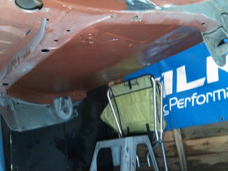

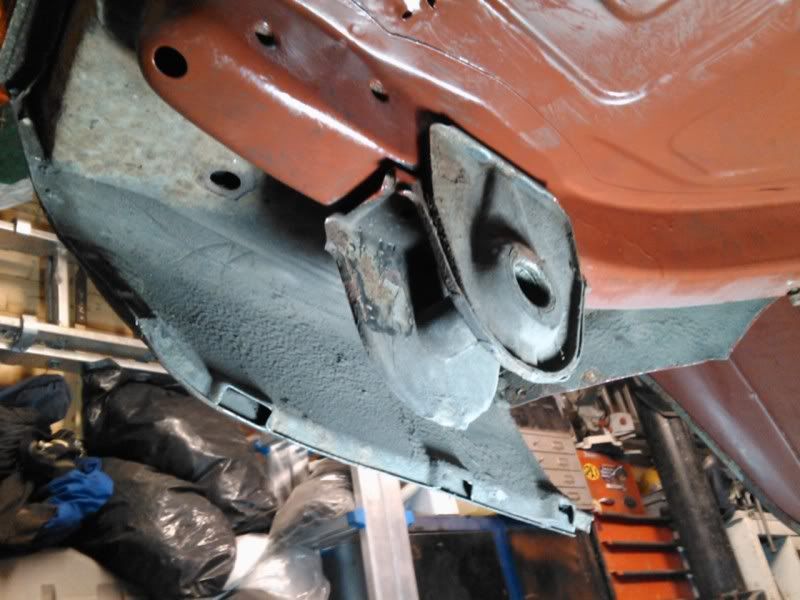

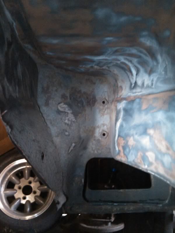

My question as promised. I am finding it hard to access certain areas of the underside of this shell. I have gone as far as I can with the grinder and drill, but there's areas I just can't reach. See pics.
Front inner arch/rear of front panel
Inside of lower rear quarter panel
Rear jacking point/spring hanger
What do people use in these areas? They look fine for the most part, but a quick wire brush and then lashing paint over the top isn't an option. I am going to get my compressor back from a mate, then lend another from another mate (same comp), link them together and attempt to use my spot blast gun. Although it was crap when I tried it on a rear beam in the past! I also forget I have some Bitlhamber Deox gel there. I guess that will help quite a bit.
Any ideas?
