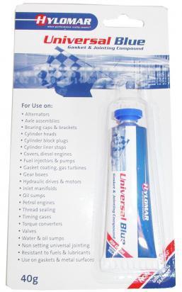

I've been advised by a Volvo tech to make new paper gaskets and use in conjunction with blue hylomar gasket compound.
This stuff:
It sounds impressive from what I have read. Anyone had any experience?
The 'Universal blue' name is familiar, I have definitley used that before. Don't recognise the Hylomar name though.
I'm very tempted to clean the outer surface of the diff/box and see if I can seal or at least slow down the leak first.

Hylomar
...is THE stuff everyone is useing here. it's even officially used by the german military (which however not always is an indicator for quality ;) )
but be carefull with it and less is more when it comes to hylomar. what you use to much will be squeezed out when reassambling. that might close your oil intake pipe when you use hylomar to seal the sump etc.
