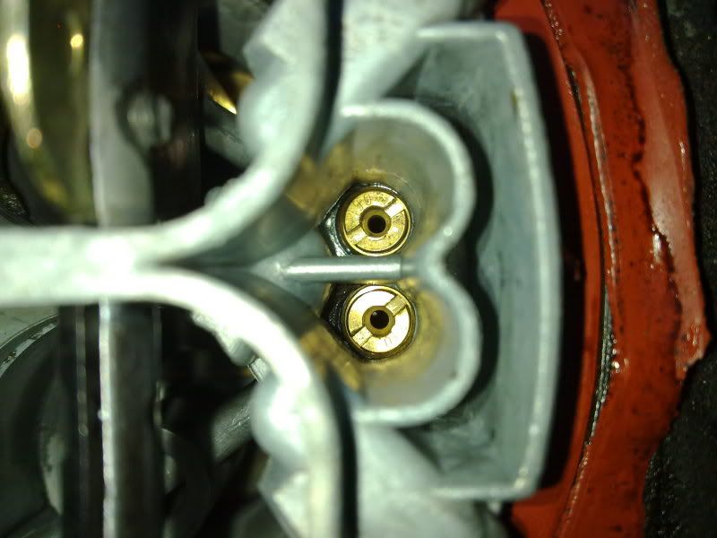

Anyway takes that out and I gave it a good cleanup aswell as the electrical connector for it and refit it, I carried on poking around and thought i'd give my jets a blast of air to make sure they're blowing clear and WTF they wiggled about!!!!
I got a screwdriver down there and tried to tighten up but couldn't manage to do it. Can they be tightened with the carb intact and I they are just being awkward for me, or does it need to be taken apart?

you can tighten them from above but can't get them loose. turn them clockwise mate
those are the main air jets, below them the emulsion pipes. for correct fuel transfer to the venturi's it is essential these are tight
also, if you touch the throttle you see a beam of fuel going into the 1st barrel, if you see any petrol leaking into the 2nd barrel it is worth it to take the floaterchamber cover off and tightening this; the acceleration jet
