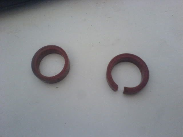

right found the problem
the oil feel pipe has a little orange/redish seal/oring that sits the the block right?
well its not, well not all of it anyways!
hoping the 940 one will be a direct swap.
Ben
Ben

Re: Low oil pressure - sorted
Where does that go then? It looks just like the seal for the turbo oil return pipe that fits from outside the block.
it fits round the output tube of the oil pump. There's an O-ring at both ends, where it leaves the oil pump and where it enters the block.
I think I remember reading about it somewhere might have been the 700/900 maintenence FAQ...so it must be a very common fault on redblocks.
