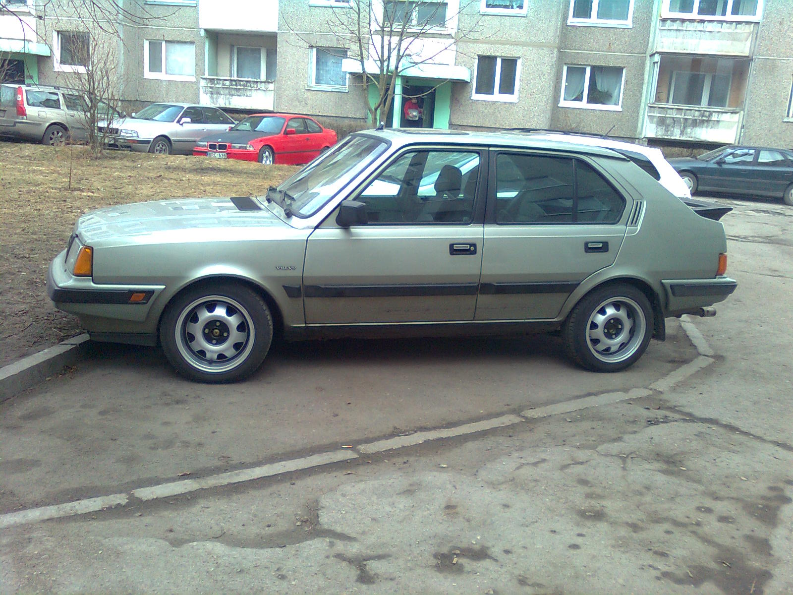

i have one doubt about my wheels, won`t i have any problems with the wheel size, the rims are R15 and tyres - 195/55 , won`t the tyres scrub my arches?

Re: valdemaras volvo 360
what's the ET on those ATS rims? usually these are 35 or 20 for the 15"wheels
the 195/55 won't rub but; if you change the tires put 195/50 on them; these have exactly the same outer diameter as the original tyres so the speedo stays the same
the ET seems to be 35, if they were 20 i think then the tyres would lean out a lot more, but to be 100% correct o chek that out
i'd worry more for a et higher than 35; the free space between tire and front strut gets really tight then...
if you're shocks/springs are in o.k. conditions they won't rub even if they are ET20
on those stock wheels of mine volvo are written ET40 and no problems with 185 tyres.
here photo with ATS

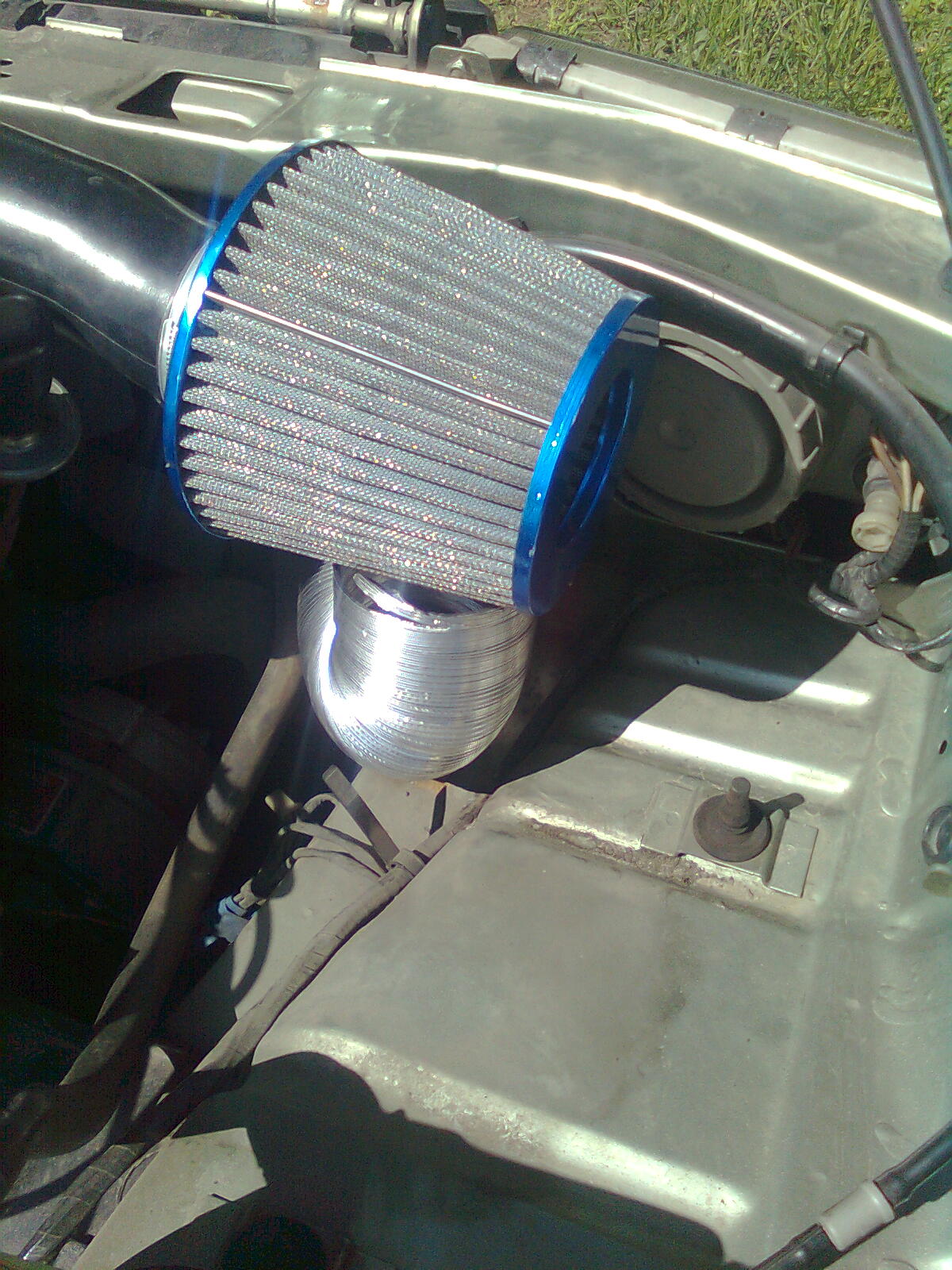

putted cone air filter (a few years ago friend gave it to me, and just a few weeks ago i remembered i have it
) so it was a hell cheaper then to try to find and original filter here in Lithuania
and maded some air intake for it
