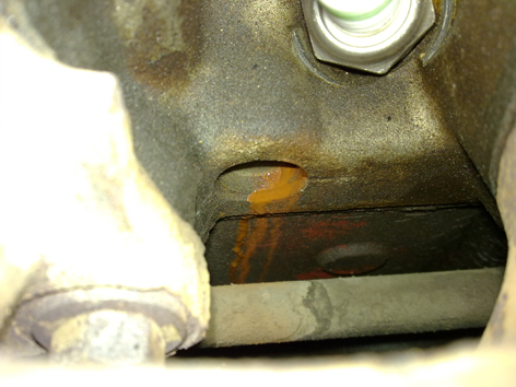

Hi guys,
I have found a water leakage in the cylinder head of my B19E under the spark plug 2 and between the first two exhaust tubes...
Is it a cap that I can change ? How can I fix that ? Do I have to weld it ?
Sorry to bother you but I can't use my car anymore :cry: until I get this issue fixed :oops: !!!

Not sure where that is exactly, but looks like a core plug. Its just a bit of dome shaped steel. I believe you just punch it with a screw driver and lever out carefully, or possibly use a large self tapping screw. You just tap in a new one, maybe with some liquid sealer.
You may have to remove the head to get at it properly. Any decent engine internals part supplier or reconditioner should have standard core plugs.

Thanks a lot "Ride_on" for your reply :D
It seems that this plug is designed to pull out of the cylinder head if the water freezes in the engine...
I have purchased the plug from my Volvo dealer :D Oh yeh they do have one ! :lol:
I drilled a hole in the fitted plug...put in a screwdriver...and pulled it out...
I coated a thin coat of aluminium gasket silicone on the new plug...located it in the hole and used a hammer to fully insert it in the cylinder head like it was before...
Btw I have pulled out the exhaust manifold...can I reuse the same gaskets or I have to find some new ones ?
