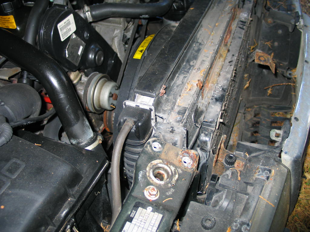

Here's a few pics showing the 940 IC and boost pipes fitted to the 360. I don't remember how many were posted in this thread, but they should help.
I had no intention of running the car with it, it was just fitted for testing purposes. Like John says, you can see, there's many things in the way of it fitting. If you don't want headlamps then you could get past the width issue lol, but the height is always going to be a problem.
and a Renault Trafic one, just for good measure lol.
Image#
This effectively fit in the space once I had trimmed off the OE brackets, but the outlets were in the wrong place for where I wanted my boost pipes.
Speaking of boost pipes, I have routed them through the original CAI holes in the front panel that you refer to. I suppose it depends where you're planning to fit your FMIC, lower down or in the vast empty wasteland between the headlamps?
Mine is there for numerous reasons, but very highly up the list was that it gave my 'grille' something to frame. It's no secret I depsise the front end on these when mostly standard. lol

Thanks for that, I think Steve is right, my donor does have AC. And I don't want to weaken the front valence area by cutting a hole in it but the AC compatible intercooler looks to be a little smaller than the non-AC/top entry type. Its tight but worth checking, I'll double check it once I get the rusted screws drilled out.

Sounds promising mate. Having the outlets positioned lower down may just squeeze it in width ways, but unless it's a different height then you're probably going to have to look at using another one.
Here's a couple of pics showing the dimensions of the 940 FMIC. Maybe it will save you pulling one of your cars apart for sizes? lol

It is lower in height than the non-AC version, it actually fits under the front brace thingy, width wise looks just about ok. There are some metal plates above but they can easily cut-off.
