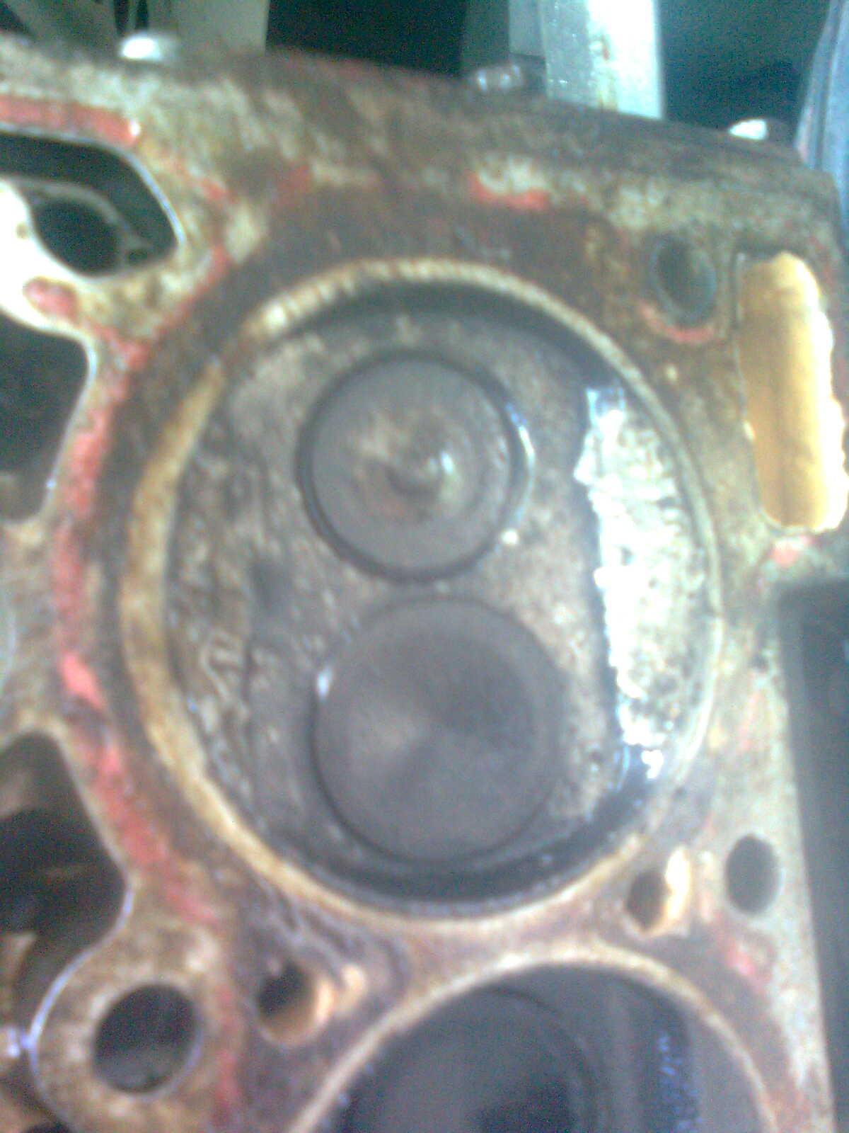

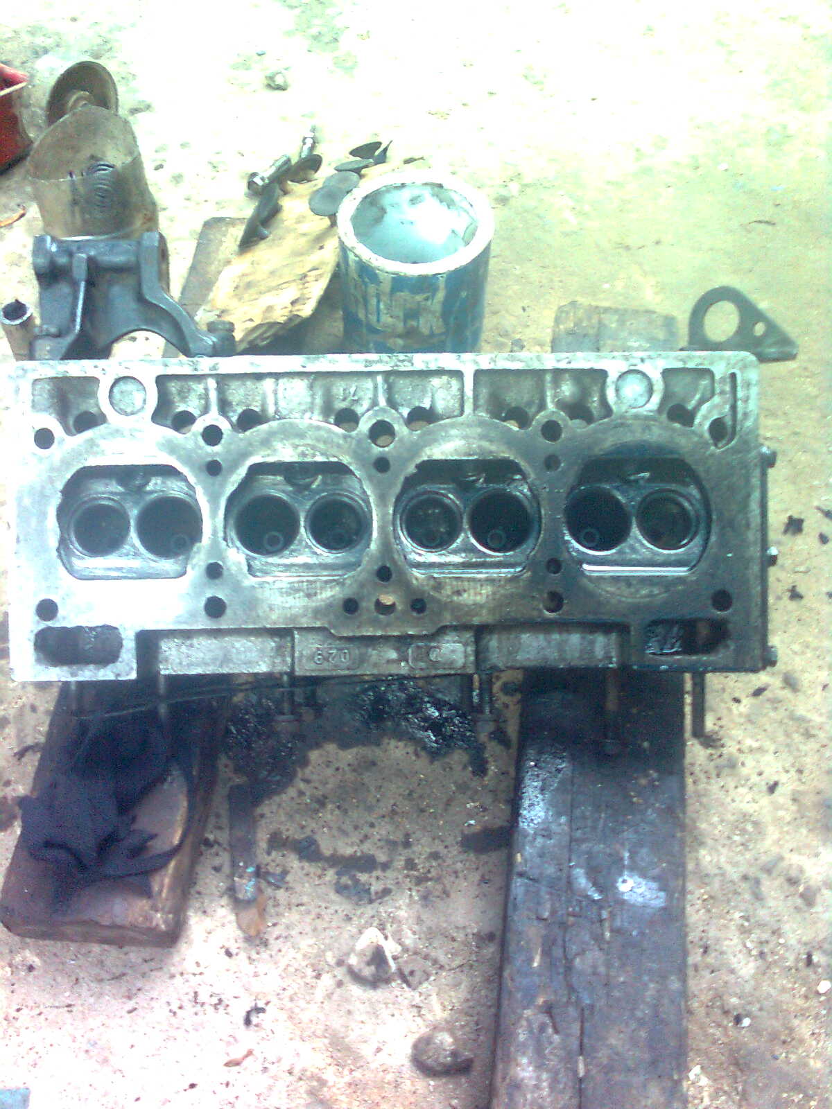

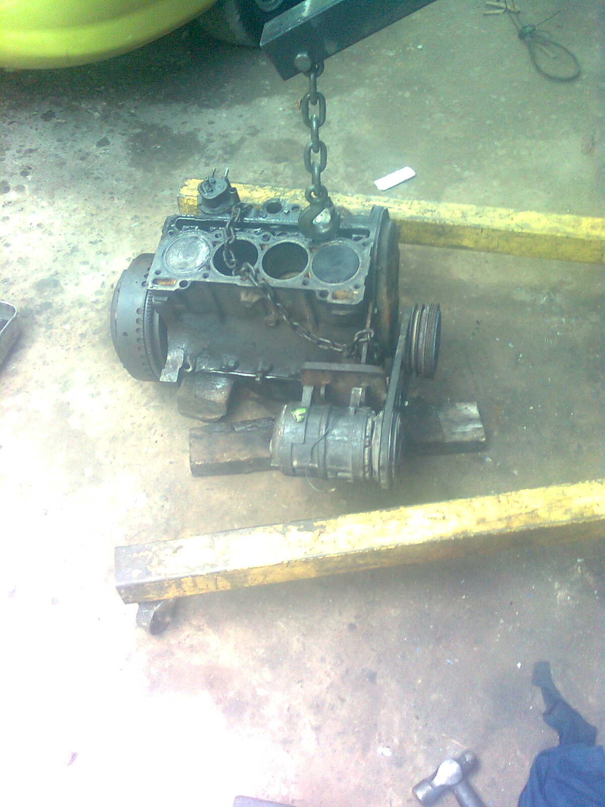

piston ,PLUG ,HEAD was damadge :shock:

Blimey, that's a fair old hole!
If you need any replacement bits for the engine, give me a shout, I've still got my old one that I removed from mine when doing the valver conversion. 53K miles, ran really well.

If I was you i'd drain the oil and take the sump off to make sure no bits of the piston or whatever caused the damage that may have gone through the hole in the piston are in there that could cause damage to the crankshaft and bearings below, you would have serious problems if it does.
shamil
Posts: 51
Joined: 30 Jan 2010 10:40 am
Re: B14.4E problem, URGENT HELP required
Post by shamil »
morgan105 wrote:If I was you i'd drain the oil and take the sump off to make sure no bits of the piston or whatever caused the damage that may have gone through the hole in the piston are in there that could cause damage to the crankshaft and bearings below, you would have serious problems if it does.
of course i did that i wanted to know what damdage the engine,found parts of the broken piston and a metal peice in the sump ,its beyond recognition
