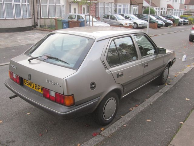

I'm Mike from Middlesex (only just - in the NW outskirts of London) - after a bit of eBay roulette, I "accidentally" bought a 1989 340GL vario a few weeks ago. All Sam Glover's fault really as I've spent ages looking for a good Volvo 66 but I was inspired by his recent 343 purchase in Practical Classics to have a look at the 300 scene and the rest is history...

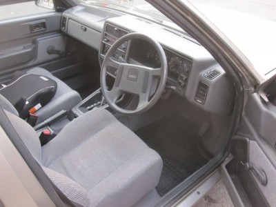

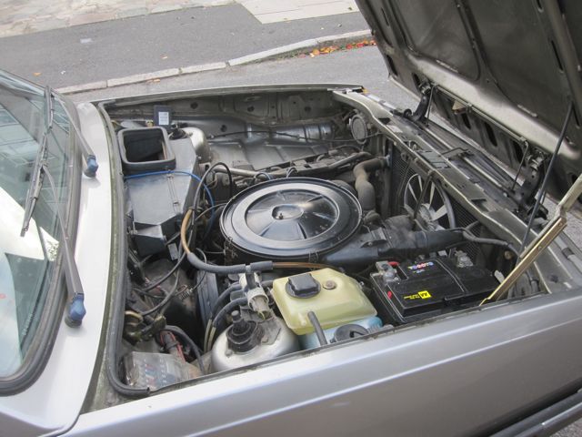

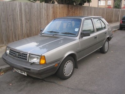

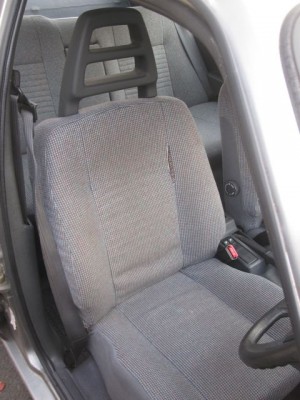

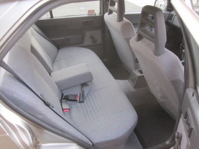

Anyway, enough about me. The car's got less than 43k miles on the clock, one old lady owner from new and in very good nick despite not being garaged. The only evidence of any rust is a small repair to the o/s/r sill, everything else is solid and original, even the front valance. The only slight cosmetic niggles are a split seam on the driver's seat backrest and the fact that some of the segments on the LCD display of the original radio aren't working. On the mechanical side, the engine is as sweet as you like but I'm have one or two intermittent issues with the transmission which I'll post about later in the technical forum. In the meantime, here are a few pics of the car after a coolant flush and a quick clean...
