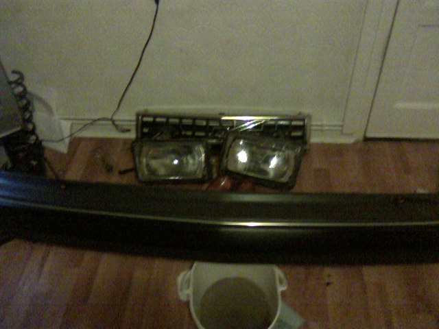

Polishing the headlight reflectors and 'do' the brake lines, bit of detailing going on too:

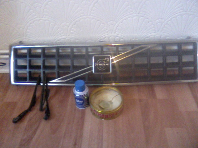

Re: what is this part called?
really want a prancing moose or mr.horsepower
Once when i was on e-bay i typed in Volvo badges and a
load of those prancing mooses came up.
I found some metal ones for sale a while back from some german site I think. hmmmm... did seem to be very limited stock though.
