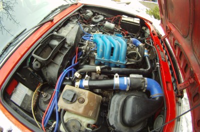

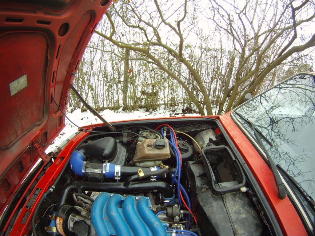

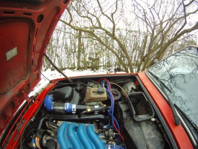

Pics of the enginebay. Sorry for gopro.
I dont think, this would help you...
If you are interested in some details, please ask!
Re: 340 turbo help? (trundle)
I wish my B18ft not done project was left hand drive!
Good use of the 360 air box too.

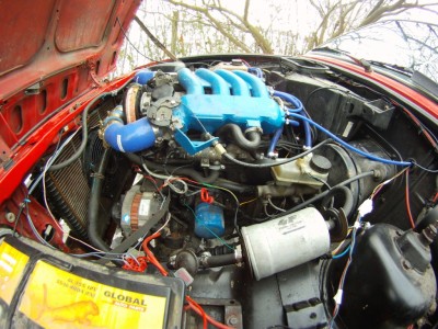

i have dun the starter motor i just need to know if any of these need to be connected i was told the big bunch of wiers are not needed ?
T.J.
Posts: 248
Joined: 06 Jul 2011 04:44 pm
Location: Bedford
Post by T.J. »
you have been busy :) I see fuel lines and all the water hoses are done.
The coiled up wires coming from the alternator should be for the old 480 infocentre, so hopefully you can just cut them off. The 3 (blue/orange/white) are for the original ignition coil.. just look it up in the haynes book ;)
