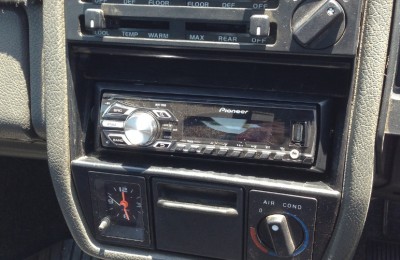

Well, today my adapter arrived and after a lot of annoyance and getting cranky cause I couldn't find any tools in my dad's shed... here's the result.
BEFORE (with big gaps and all) NOW

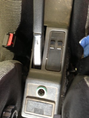

Much, much tidier! (where do they hide the cigarette lighter on these air-con cars?)
- williswoody
- Posts: 102
- Joined: 02 Oct 2011 10:55 am
- Location: Queensland, Australia
Re: Will this fit my '84 360... ?
Cheers! The cigarette lighter is back up near the rear ash tray. The air conditioning on my car doesn't work either, I was quoted a maximum of $1,500 Aussie dollars to get it refitted, because it's based on an old and now illegal gas system...
Oh well :/
Oh well :/
1984 VOLVO 360 GLT HATCH Owner. First car. Aussie. Uncertain of it, after it's started playing up lately :/
That's MILES away! (for a mobile phone car dock on the windscreen)
