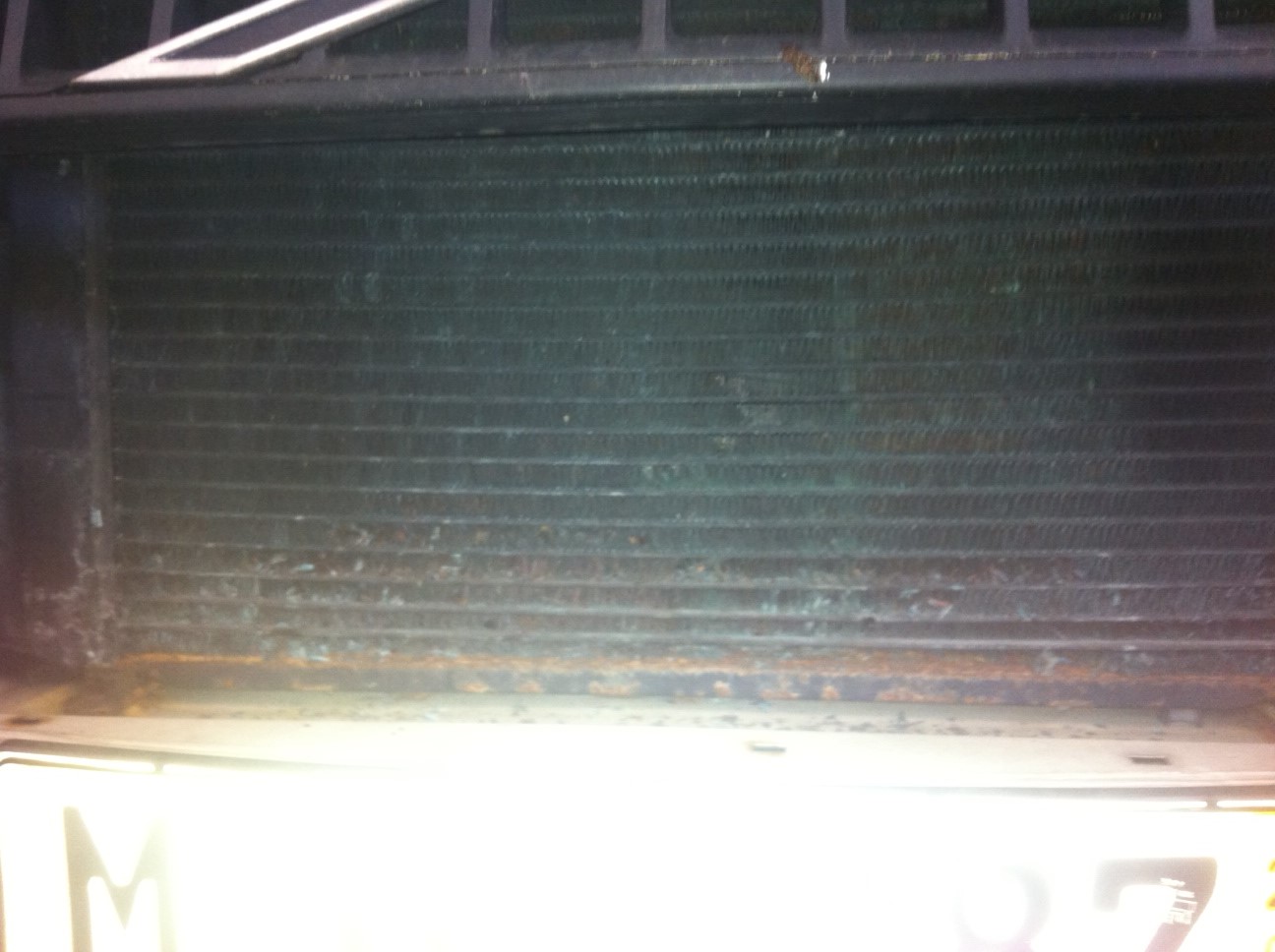

But before that I will have to get a new water cooler... I could get the fins out easily by caressing it with a brush...:
