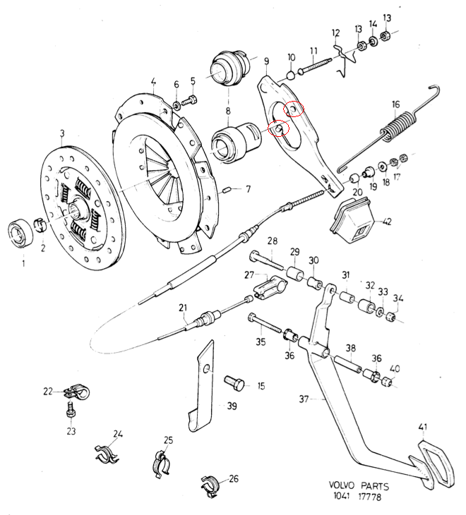

Re: Clutch pedal noise, is this dangerous?
have you tried a bit of machine oil on the moving parts? it does sound like a rusted pin/hinge type creaking, its not the diaphgram if it makes the noise with the engine running.. I reckon the release fork pin/hinge assy is creaking
have you tried a bit of machine oil on the moving parts? it does sound like a rusted pin/hinge type creaking, its not the diaphgram if it makes the noise with the engine running.. I reckon the release fork pin/hinge assy is creaking :
- Attachments
- koppling.png (133.16 KiB) Viewed 18411 times
