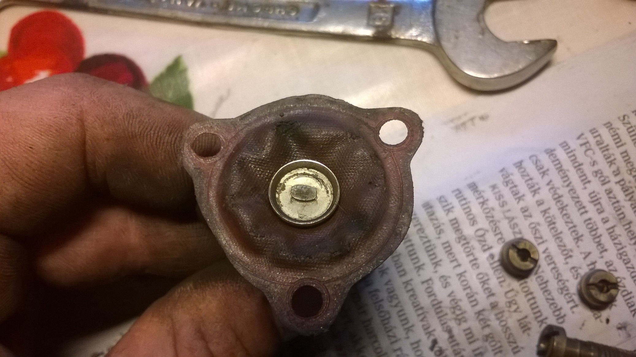

The choke pull of diaphragm not in good condition

Well - your full load enrichment diaphragm is definitely split!.
The choke pull off actually does not look too bad - the "crumpling" is normal - the key is does it leak?
When you reinstall the full enrichment device cover make sure it's positioning is correct - the W symbol does NOT sit horizontal.

Thank you.mac wrote:Well - your full load enrichment diaphragm is definitely split!.

choke pull-off maybe usable. I live in Hungary. I think the post little expensive
