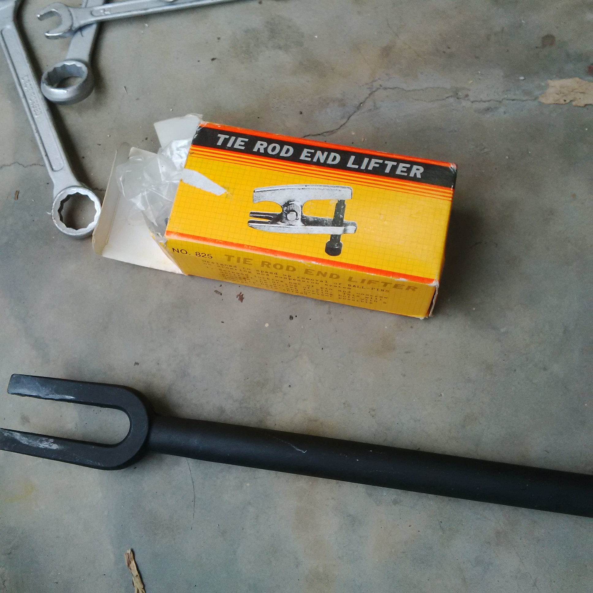

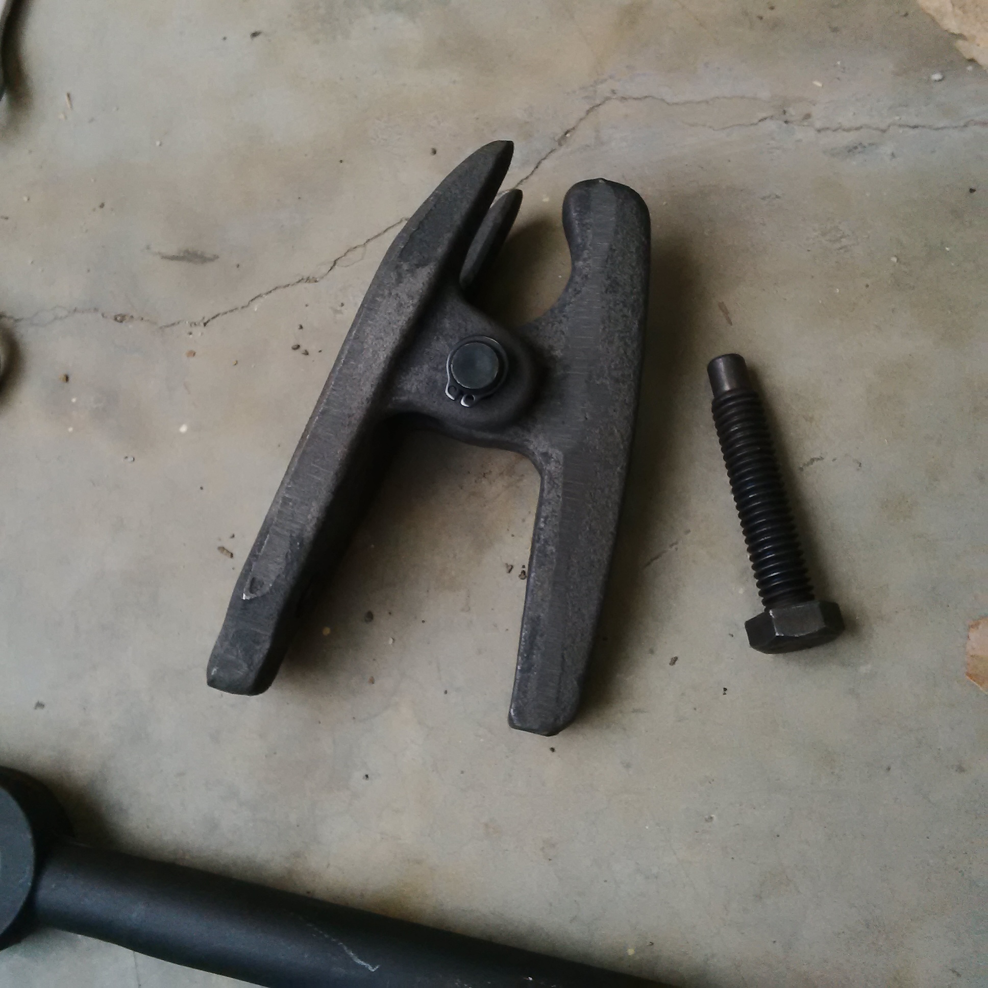

Hi guys, today, I finally at last able to pop out the tie rod end using special tool, that I bought, not so long ago.. the fork will have to wait another day..a bit tricky when loosen it counterclock wise. Only left is the screw that hold the rack and the pinion. Do I have to loose the one coupling inside the car or from out side..
Thanks guys
Zack
Fork meet your cousin..
£5 only.. made in china.

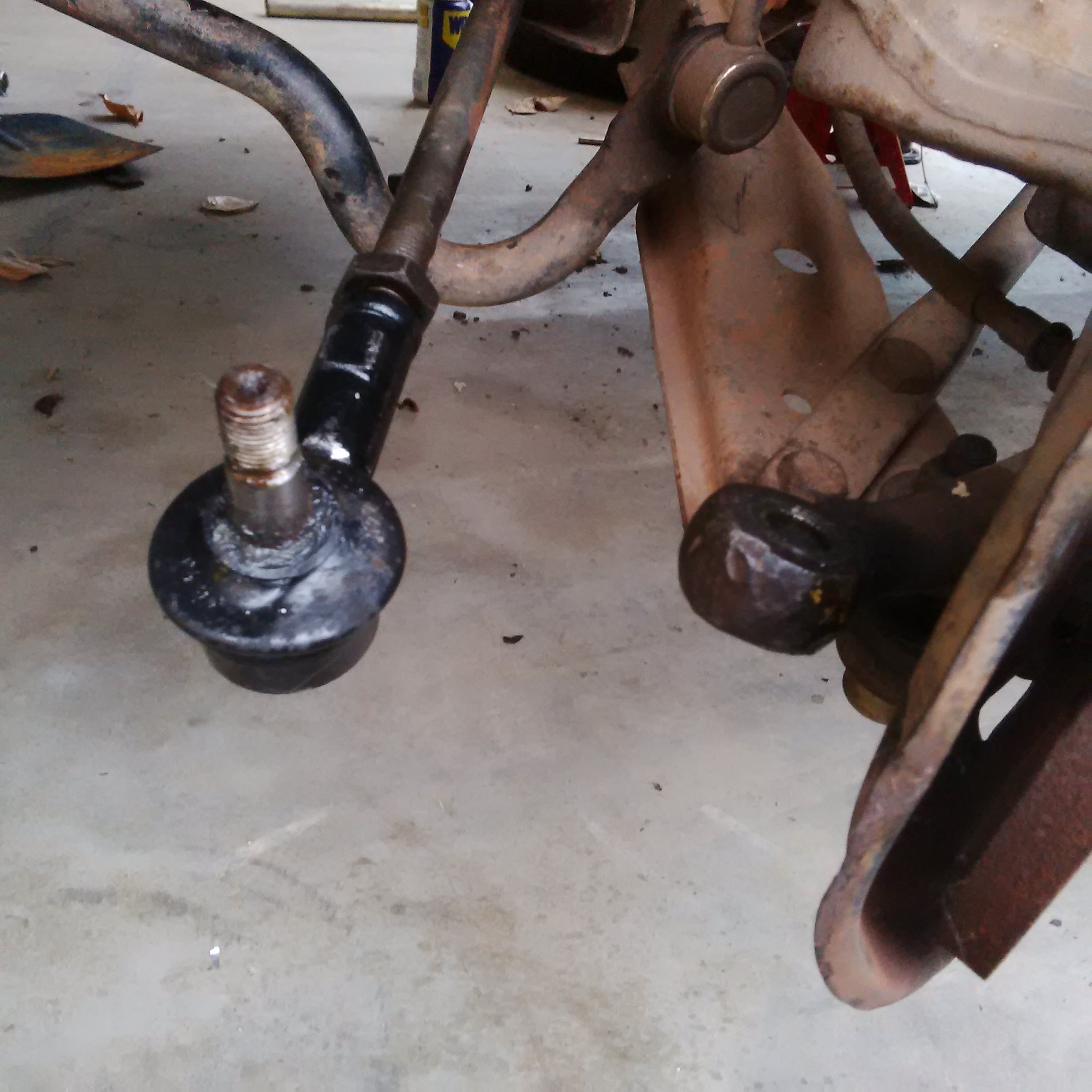

This is how I put it
Right Hand Side
Left hand side poped out

I could be mistaking but isn't your sway bar the wrong way up?
zack360
Posts: 227
Joined: 29 Apr 2013 03:27 am
Location: Malaysia - Kedah
Post by zack360 » 17 Jul 2014 05:10 pm
I'm not sure, looks fine to me. What should I do?

zack360
Posts: 227
Post by zack360 » 17 Jul 2014 06:05 pm
Confirm by my mate.. it's wrongly installed. Thanks.

Post by bogbasic » 17 Jul 2014 06:35 pm
There's a nice nipple on that calliper.

it is downside up. how odd.

Post by zack360 » 18 Jul 2014 03:33 am
I think this the main reason why my steering feels so heavy.. :?:

Post by zack360 » 18 Jul 2014 12:54 pm
Thanks for the info joris

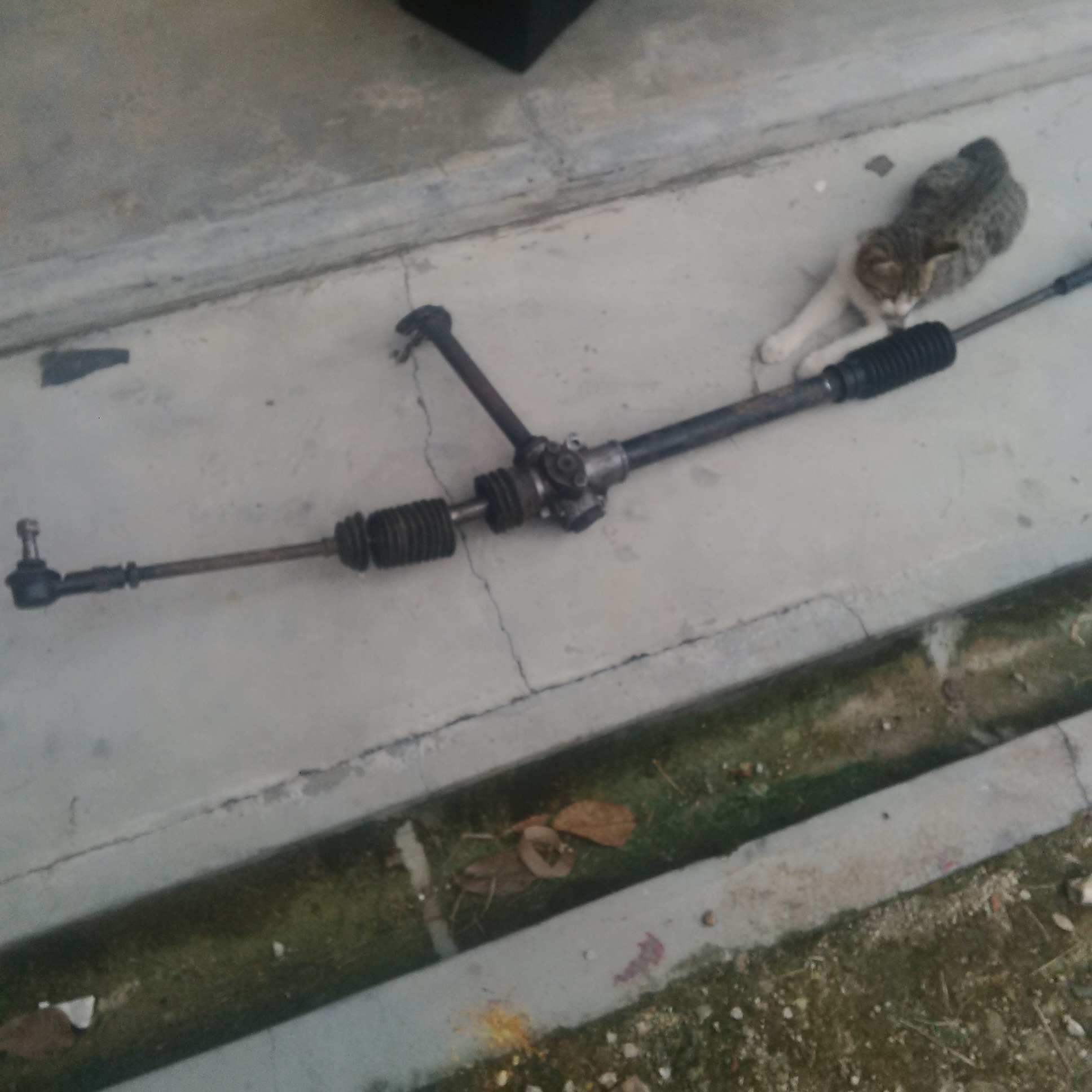

Post by zack360 » 21 Jul 2014 08:55 pm
Finally, got it removed. Now, need to find a power steering set, the one I got is not compatible. I use a box socket with Allen key number six to remove it. Before that I need to remove the coupling above the joint, it have 4 number 13 screws and nuts. The rubber was torn and beat up badly. Need to replace this as well.

mac
Posts: 1403
Joined: 19 Apr 2006 11:02 am
Location: Needham Market U.K.
Post by mac » 21 Jul 2014 09:07 pm
Zack, you'll be pleased to learn that the power rack does not use the the composite rubber disc/flexible joint (it uses a UJ)
If you look at the parts listings and diagrams I sent you they will show the differences between the manual (excl.p.s.) and power (p.s.) systems.
When you find a car to "rob" get the lower column with all the joints as well.
The parts diagrams will also show you what things should look like and the lists show the quantity of bolts etc.
Mac.

Post by bogbasic » 21 Jul 2014 11:26 pm
The cat is an absolute darling.
